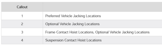

So I purchased a C6 Corvette a few months ago. It has a very specific set of 4 jack points you need to use to not cause damage to the vehicle when lifting. I have a 2 post atlas BP 9000 lift, and it is impossible to hit all 4 of these jack points at once. The lift points on the car are too close together, and no amount of adjusting the arms and/or repositioning the car can get me there.
I see products like this that may work but that part of the arm will just be too thick to get under the car.
I'd have to drive the car up on ramps every time before swinging the arms under.
Could I just buy another set of front lift arms for the rear since they're shorter? Any other solutions on the market for this issue?
