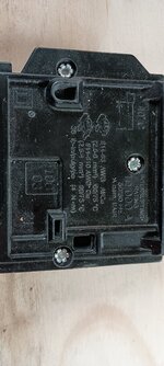

I ended up changing out the 200 amp main disconnect breaker that had the lugs. That one lug had heated, sputtered, and welded until it ultimately was no longer safe. It just wouldn't make a solid connection anymore. Fortunately HD had a QOM2200VH on the shelf, so I was there before 7 the next morning to get it. 30 minutes later I feel much better about it.

I'm curious as to how you got from "fixed it" to reopening and changing the breaker? GJ guilt? Curiosity? Flickering?
mm08822
Jan 13, 2012
6,139
Open the housing on the old main cb and see how far the heat damage traveled.
Try a 4" grinder with cutoff wheel to delicately open it up.
PCustoms
Jul 23, 2011
23,684
VT
Pretty solid now. Why would you expect something else?
My industry experience and thermography certifications.
That little bit that looked bad in the first place was just the top of the damage that occurred due to the original loose connection. You got a little more of it by swapping the breaker, but you. Certainly haven't posted enough for anyone to tell if it ended there. Or if the wire upstream needs more work.
Frankly for what you paid for that main breaker it might have been easier/cheaper to swap the panel. Assuming the same panel is available it could have been as easy as swapping the guts.
Panel is fine. No sign of any heat beyond that one lug on the breaker. The way those breakers mount, the whole thing would have to melt down to pass any significant heat through to the rest of the panel.
