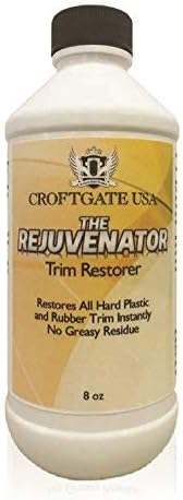

The show car industry has this one covered.
This stuff works great.....

Can’t remember the name. But this forum had a thread in the past about some product with one of those self-evident names. New Plastic? Plastic Renew?
Highly praised by other posters. (Wish to heck i could recall right name.)
