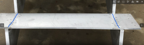

Hello, New here and wanted to chime in:
I just tried exactly that, (I'm building some stringer satircases with 1" x 12" stringers and 1/2" tread plates). The tread plates are welded to the stringers from underneath and therefore bend down in the middle. So I tried to heat the weld line on the opposite side (up side), cooled it with a water hose and now the bend is twice as much. Shouldn't I air cool the heated area? (somebody once told me that if you flash cool (water hose), your'e actually stopping the process)? Confused, please help
Thomas
You need to cool the opposite side of the the tube the the treads are welded on.

I will take pics today and post here. Maybe that'll make it easier
Without seeing the pictures, I would probably try heating the middle of the tread on the bottom, and let it air cool.
After seeing the pictures I would do the same. Mark the middle on the bottom of each tread and heat it up similar to the size of the weld to start ie: a 2 inch strip on the front and back of each tread.
Those will be awesome when finished though!
AustroTom
Dec 29, 2023
6
Attached are the pictures.

Without seeing the pictures, I would probably try heating the middle of the tread on the top, and let it air cool.
After seeing the pictures I would do the same. Mark the middle on the top of each tread and heat it up similar to the size of the weld to start ie: a 2 inch strip on the front and back of each tread.
Wait, so what your'e saying is I should heat the "center" of the tread plate?? This will bend the plate down even more because I would "shrink" the upper layer of the plate, no??
When I heated it up yesterday (and flash cooled it), it even bent down further. Was this due to the fact that I didn't heat it up enough and therefore the weld stress pulled it even more? I just dont know how much to heat for the upper material to start shrinking (pulling)
Thank you. They will in the end have a 3" wood tread with glass railing (which I will also have to build the frame for
Yes! You are right, I was thinking backwards. Bottom of the tread plate in the middle would be where I would start. I will edit my post to save the confusion
It wouldn't be the first time I heated the wrong side and watched the bend grow tho...lol
AustroTom
Dec 29, 2023
6
No matter where and how i heated it wouldn't straighten so i just took the hammer to it:giggle:.
Pounded them out just outside of the welds and worked like a charm. Not concerned about the dimples since it'll be completely veneered with wood anyway.
Thank you for all your input though.
Thomas
You didn't heat straighten is correctly that's why,
With those stairs you clamp it straight first.
Then heat it along the lines shown [opposite the weld underneath that is pinching together]
Because it is clamped it can only expand to thicken the plate [instead of bending the plate more]
Once cooled the plate will normalize straight [because the now thicker part shrinks and pulls]

Thank you for your tip. I will certainly try that (although I actually did that as well). I have one more staircase to build.
BTW: the same happend with building the railing frame (Inserts are glass). When welding the 1" x 2" rect. alu tubing as cap rail to the vertical posts the tube obviously bends (shrinks), down towards the weld. Again, I tried heat shrinking, (yes, overbending it back via backwards clamping and heating), but it still didn't want to straighten.
Here is what i did to fix it: I welded the top of the tubing, just as i did underneath to weld to the verticals, and this brought the tube back up in a straight line. Now, of course this means grinding and sanding the upside of the cap rail smooth. But it turns out it is still less work and headache than trying anything else. Anybody agree?
