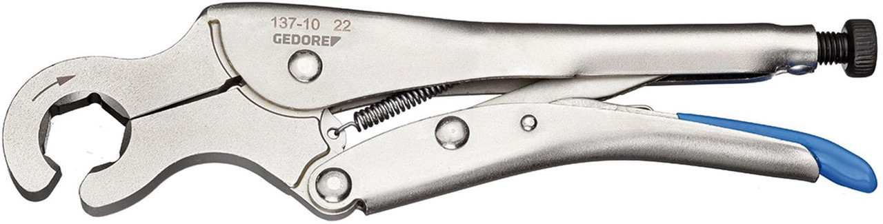

They do look interesting. I've seen similar from Gedore so they may be available from other brands. 'Grip wrench.' Bit pricey.
https://www.gedore.com/en-de/products/zangen/gripzangen/137-gripschluessel-/137-10-24---2788349

Yes, sizes 10mm to 27mm for the Gedore. Haven't used one but I guess you get a tighter fit than using a flare wrench so reduces the chance of slipping. :dunno:
Product description
For working in confined spaces
For worn bolted connections which otherwise could only be opened with extreme difficulty
Problem-solver for vehicles and industrial purposes
Particularly suitable for brake lines, adjustment of track rods, etc.

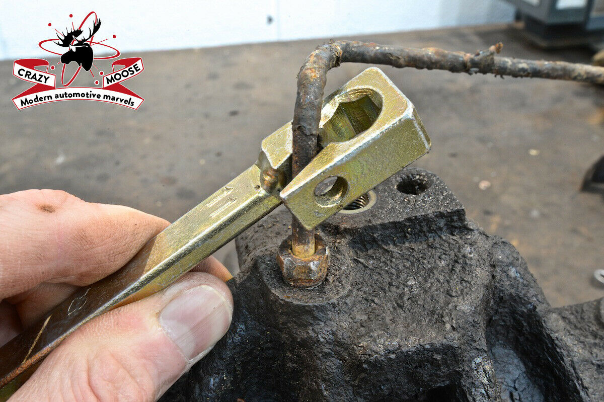

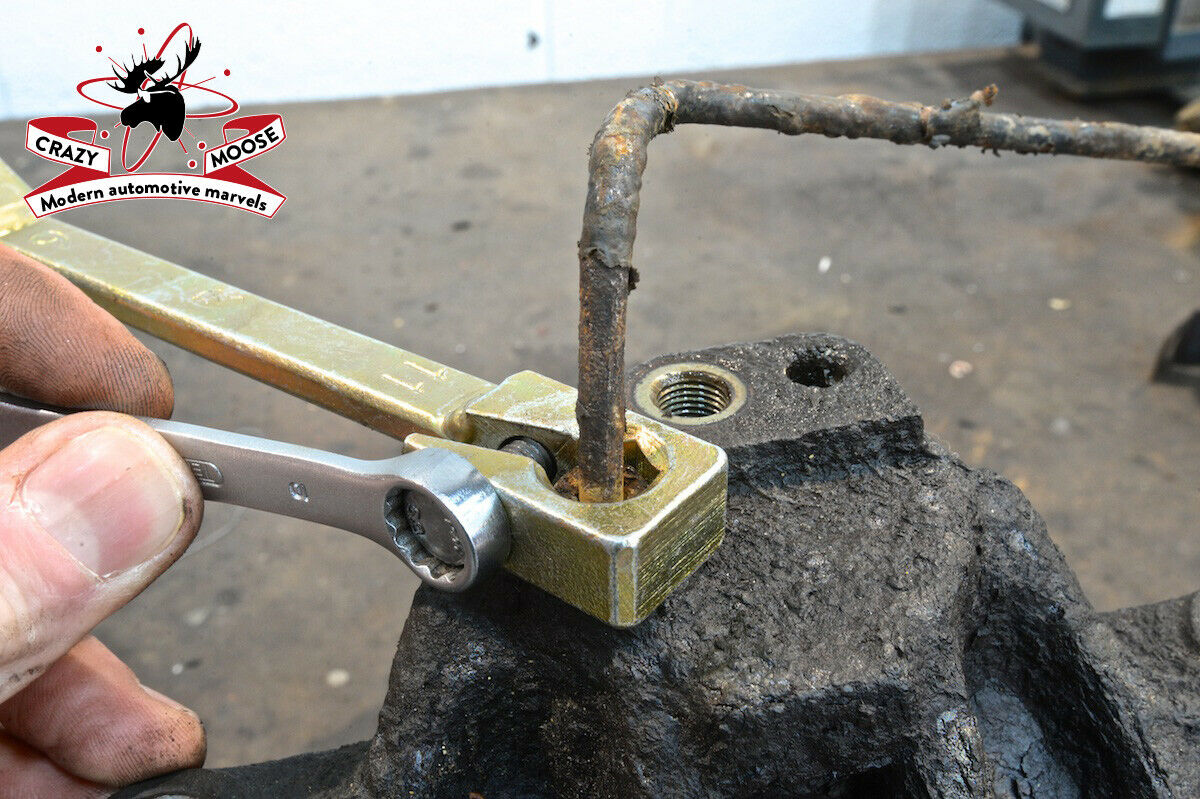

Spotted this on Ebay. Sold as 'an innovation of the Soviet Union.'
Cheap tool, just posting as I haven't seen these before.
