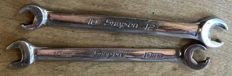

I currently have a set of Gearwrench flare nut wrenches (9-21mm) that have served me well but I am looking to upgrade considering I have a decent amount of flare nut work coming up.
I’ve narrowed my options down to two:
1. Purchase the Proto set (J3700M) that covers 7-17mm with double flare ends.
2. Purchase two Snap On wrenches 10mm and 14mm (RXSM10B, RXSM14B) that have a flare end and regular open end.
My truck only has 10mm and 14mm flare fittings so the additional sizes are a rare or never “just in case.”
But I have a 20% coupon for Zoro and get the Proto set for $93 delivered.
I have a buddy who owns a shop and I can get on to the Snap On truck and buy the two specified wrenches. Assuming I get no break on price it looks like both will cost $105 total.
The $12 difference is nothing for me.
I want high quality flare nut wrenches. I’ve always known/read that Snap On is king.
And I love the idea of breaking the fitting with the flare end, then flipping the wrench around and backing it out with the open end. Versus semi-struggling to continue to back it out with a flare end.
So…I believe I’m going to just buy the two Snap On wrenches and keep the Gearwrenches for the other “just in case” sizes.
In your opinion is this a sound plan or should I go with the Proto set?
Thank you.

I own the Snap On - those exact wrenches with the flare one end and the open end the other, and I think they’re about the best.
I think the open end is primarily for pipe unions that just have two flats, but it’s thicker than normal open ends, so gives you another option.
Can’t fault this option. I’d rather have two really decent tools in the sizes I need than something lesser in sizes I don’t. Having said that, I doubt Proto are bad.
If you wanted another option, it would be to buy just the sizes you need from another manufacturer, but the Snap On are the best I think.

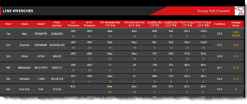

I have a set of the Snap-on flare nuts, and they are worth the hype, but Proto did really well in torquetestchannel's testing. If I were choosing again today and could get a good deal on a set of the Protos that's probably what I'd go with.
Ooof, I guess if I'm going to comment about how well Proto did on the TTC's testing, I might ought to post the video showing it. I had forgotten that TTC had done two rounds of testing flare nut wrenches, and the Protos were in the second round.
As far as their rankings go across both rounds of testing, these were the top 6 (and the MAC on top has an asterisk as they were doing really well until the wrench broke).

90ft-lb on a 1/2".... I think in most cases I don't mind that it snapped as that is some really intense torque for it.
