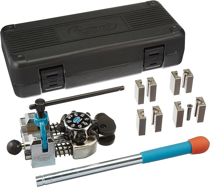

First, any one making replacement brake line needs to start with NiCopp brake line. Easy to form by hand and easy to flare.
Second, the hands down best brake line flare tool is this on, sold by Eastwood.
Expensive. Bench only !
The "runner up" sold under several brand names (so I don't know who actually invented it) is this hand held version.
Under $50
Under $50
Actually for brake lines and trans and engine cooler lines this is what I use> https://www.amazon.com/dp/B0785P58G3/?tag=atomicindus08-20
NiCopp is easy to work with but also rubs through easily and with cooler lines a lot of the time it makes sense to repair the existing by flaring it in place on the vehicle the hand held hydro tool makes that pretty easy.

Yeah, I have that Eastwood tool. Trying to do stainless steel on the lesser quality tools is an exercise in futility.

That Eastwood flaring tool is sold by many different vendors. They are all the same, so shop for the best price, I actually got mine from Inline Tube at Carlisle swap meet for a discount. It is by far the best flaring tool I've ever used. I have never made a bad flare with it, and that's steel, stainless, and copper. It has dies available to do 37 deg as well as 45 double and bubble. I don't use NiCopp, only real steel or stainless. I also have Imperial benders that are by far the best.
