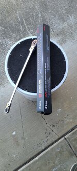

All of them are useful in scenarios where the space is deep and wide but narrow. And the tool can flex a bit. I have been thinking about making a comparison for myself for a while. Today is the day! Hopefully others find these measurements useful. And if you have similar setups, please do share the precise measurements! Now let's have some fun.
First up is the (quite) popular Tekton double flex head wrenches. I use 17mm size for all the comparison.
Verdict: 10.68mm

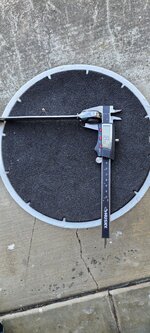

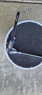

The Tekton is often compared against the Mountain/Icon long flex head wrenches. The difference is that the Tekton is 6 point while the other two are universal fit. The Tekton needs to be flipped to reverse while the other two can reverse by pushing a button. Also some claims that Mountain/Icon can be handy because the 'sleeve' on them allow the wrenches to access some fasteners with weird angle. I do not have these two wrenches. But I do have a Gearwrench quad box wrench with sleeves. The designs are very similar. Hopefully the depth measurements are close.
Verdict: 18.03mm

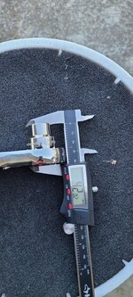

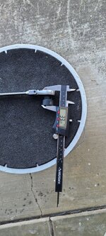

For the low profile sockets I use the popular Astro Pneumatic set and I use the Harbor Freight double flex ratchet. The HF ratchet is basically a wrench design and it is one of the best tools offered by HF. Highly recommended. The push button of the ratchet is flush with the ratchet. It does not add additional height.
Verdict: 33.69mm.
Separately, the socket is 22.44mm and the ratchet (without the anvil) is 10.68mm
