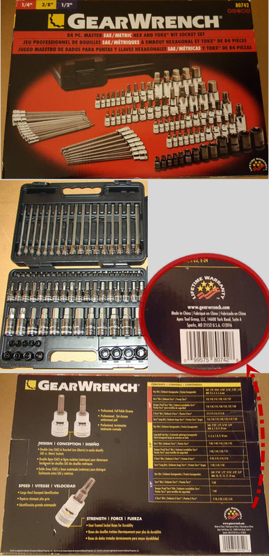

The manufacturer-date code on mine is L-AE on some and L-AF on others, so the date is 2015 (AE) and 2016 (AF), as 2001 is AA, 2002 is AB, and so on. I and others in the 'Craftsman Hand Tool Manufacturers & Date Ranges' thread had been under the impression 'L' (and 'S' and 'Z') were different manufacturing plant codes in China, but not so sure about that 'L' now.
Regardless both Craftsman and GearWrench are Apex. Most all of both Craftsman and GearWrench that was made in Taiwan are now made in China, notwithstanding Taiwan actually is China, but I digress.

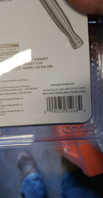

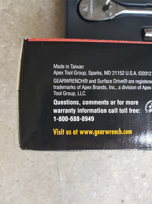

You're the only person who's showed me a pic of some GW sockets/ratchets made in China, and I'm pretty sure it was an older set, long before this perpetual changing from Taiwan to China supposidly happened. As in, it may have just been a cheaper kit that was made in China from the get go. I'm still buying GW tools left and right and keep getting Taiwan made stuff. Do I doubt they are making things in China? No, I have their Chinese full polished wrenches. That said for the life of me I cannot get them to give me Chinese made sockets/ratchets yet. I think I buy a GW tool probably once a week, or whenever somthing is on sale. Not pictured is a 84T flex head, made in Taiwan.

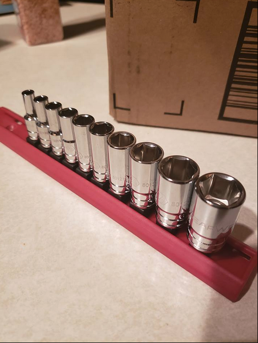

Bonus semi deeps that came in with my PS4 order from Amazon last wednesday. Also made in Taiwan but no COO picture cause I didn't think I'd enter this debate again :lol_hitti

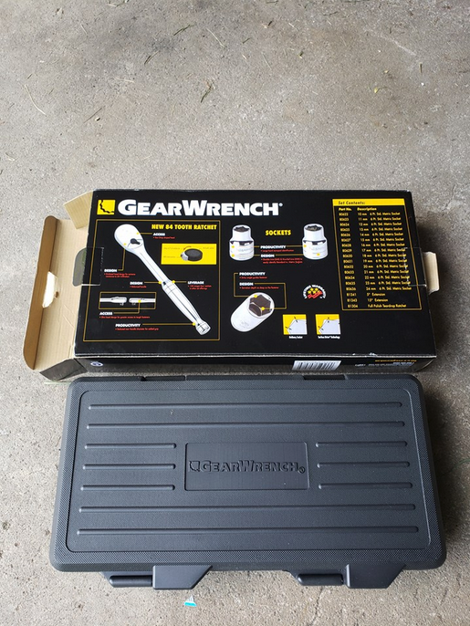

You're the only person who's showed me a pic of some GW sockets/ratchets made in China, and I'm pretty sure it was an older set, long before this perpetual changing from Taiwan to China supposidly happened. As in, it may have just been a cheaper kit that was made in China from the get go. I'm still buying GW tools left and right and keep getting Taiwan made stuff. Do I doubt they are making things in China? No, I have their Chinese full polished wrenches. That said for the life of me I cannot get them to give me Chinese made sockets/ratchets yet. I think I buy a GW tool probably once a week, or whenever somthing is on sale. Not pictured is a 84T flex head, made in Taiwan. [...]
Wish I'd saved or taken photos of more of the packages, as GW doesn't have COO marks on their tools, but here's another for you (bought this set a little more than a year ago)...
