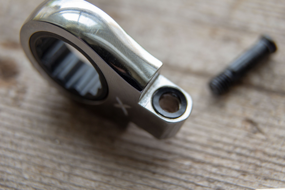

My flex head wrenches are branded Halfords but I think they came from the same factory as Gearwrench so may work the same. There is a bent metal washer that causes the friction and the washer flattens out over time.

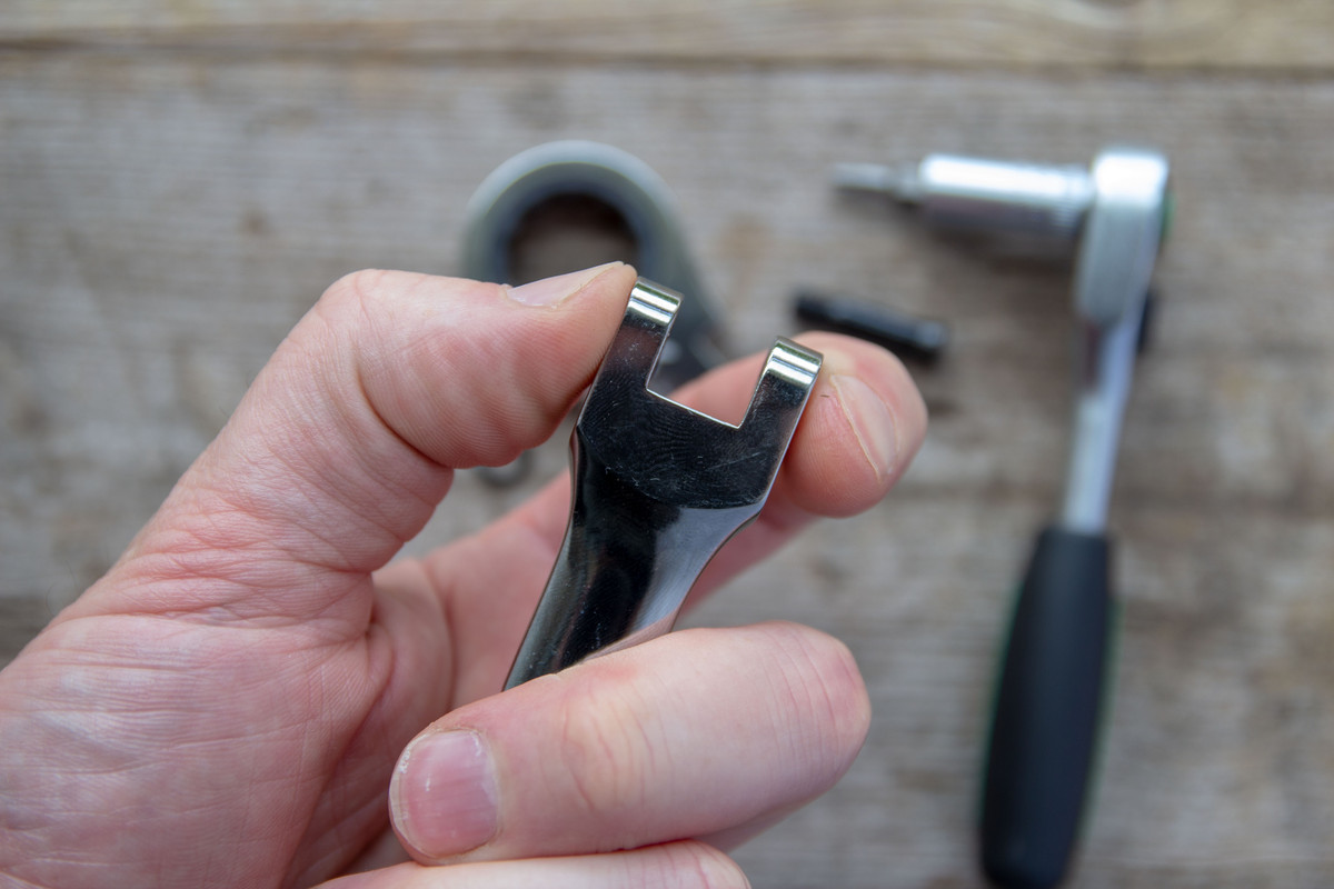

Tightening the torx bolt alters the flex a little but I think it's designed to hold the pivot together rather than as a way to adjust it.
Remove the torx bolt and see the washer inside the pivot.

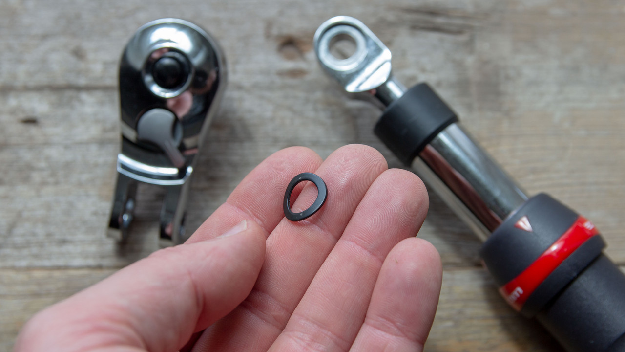

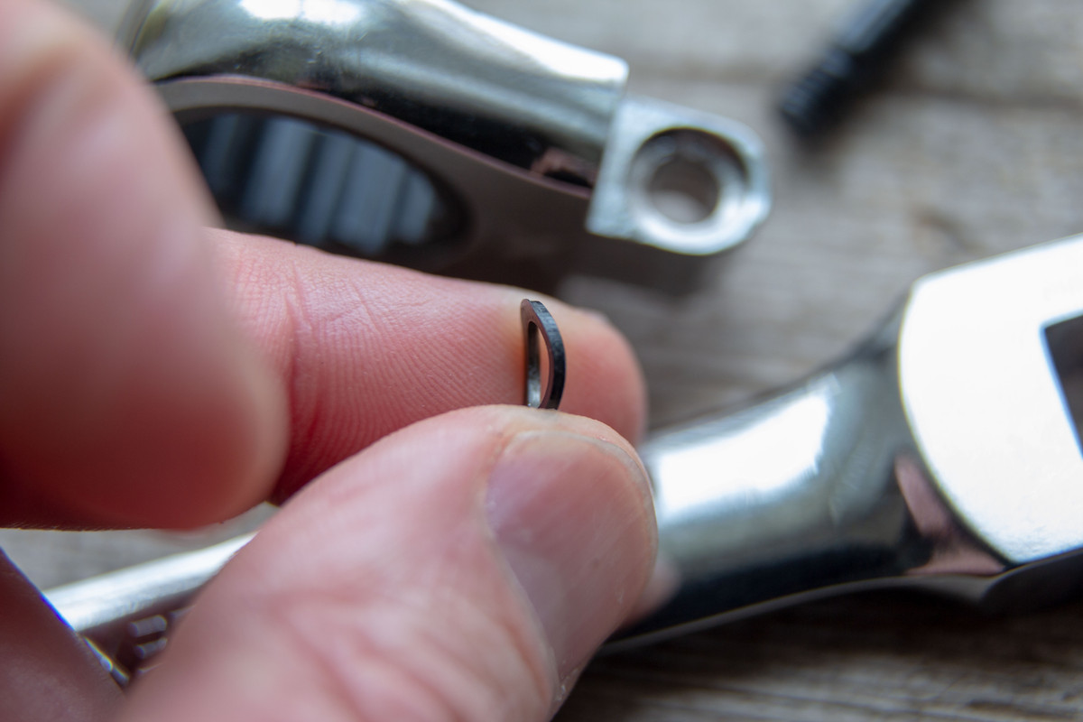

Remove washer and see that it is bent.

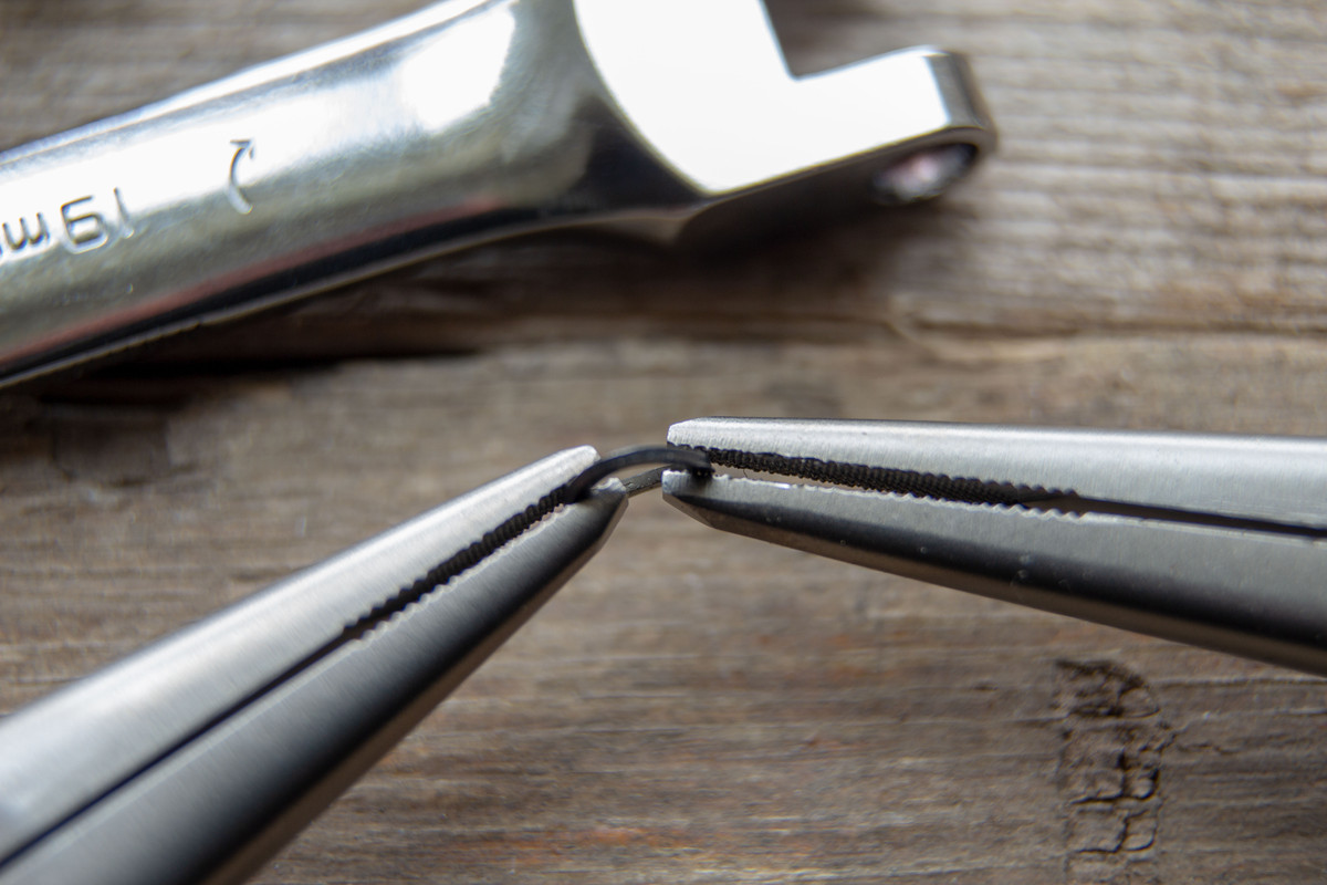

Increase or decrease the 'bentness' to vary the friction. Not had one snap yet but I image they will do.
If all else fails you can close this gap in a vice or with a hammer.
