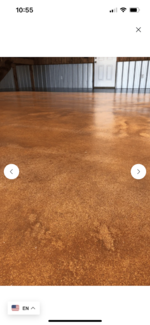

Let me ask though, acid staining with some kind of clear top coat is another option I have considered. Is that something I could do, or would I run into the same problems that polyurea would have if there is some moisture occasionally present?
Something like this pic…..

Short answer is any coating that encapsulates (seals) the slab will have the potential for negative response to MVT. This depends on the level of MVT and the specific coatings product. Some combination of coatings/preparation can handle more MVT than others. Some coatings are permeable and allow MVT to pass through them but, it's a two way street and the counter effect is also true in that they allow liquids to pass the other way resulting in less chemical/stain resistance.
Again, there are a LOT of factors that come into play in selecting a coating system when dealing with "higher" MVT levels i.e. anything above 3 - 3.5lbs per 1000sf. Rather than enumerating all of these factors the best way forward is to measure what specific range of MVT levels you are dealing with and then researching options that will address your situation.
