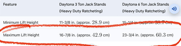

Shouldn’t 3 ton jack stands be fine? I’d likely go 6 ton for a few $ more, but I’d think 3ton should be fine?
On the Jeep or any vehicle with high clearance the 6-ton with the wider base will be more stable plus it won’t need to be extended as much to reach the frame. But it’s handy to own both sizes depending upon the task at hand.

Once I get the Jeep home I will measure to the bottom of the axle. I like the larger footprint of the 6 ton, and and leaning that direction. Not on sale, so i’ll get those as long as the axle height isn’t an issue. The 4 ton floor jack, i’ll potentially get this weekend when it’s on sale.

For a Jeep with 35" tires, for sure get the 6 ton stands since they're taller. At some point, you are going to want to support it by the frame.
