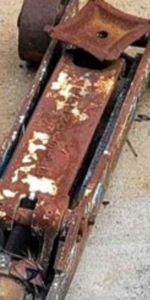

Couple years later I acquired this Walker 782... It was a mess, but it was cheap enough @$40 because it has the cast iron cover plate. When I got it. Darker blue indicates it was refurbed by Walker.
73e9f9711f296e6acdaee1add9d6aaa0-jpg.1460966
Jacks of this quality and lift are crazy expensive so I took the time to give it new life. Really wasn't any Patina (paint) to save.
My twist to the original paint scheme... I'm not afraid use it when it is needed.
5f8f67bae7d5bd284e48af02a06ae255-jpg.1460970
20220322_045411-jpg.1633041
Value? I doubt anyone would ever pay for the time and materials. But they are more valuable to me as a tool to use than resale.

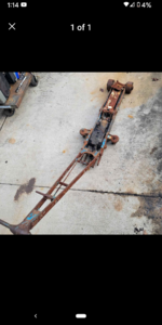

I have just recently found a old hydraulic floor jack for sale pretty cheap. It looks like it has the name green castle printed on it any information is appreciated
