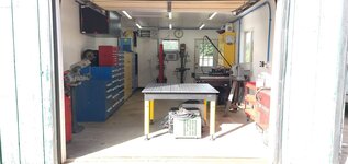

Much like @mcglynnonmaking I've used my chosen flavor of 3D CAD software (Fusion360) to model my shop and most of the contents. As far as 3D models for the tools and equipment, I've used a few pieces from GrabCAD.com that were similar enough to my existing tools for the shop layout model or could be modified to more accurately reflect the real pieces without modeling the entire thing from scratch. Several objects I have modeled from scratch, and I would encourage you to do so as it is a great exercise to learn 3D CAD software and increase your skillset. Another resource may be the tool manufacturer themselves. Although rare, some manufacturers go the extra mile to include 3D models of their products (such as Strong Hand tools in the case of my fixture table shown). One last thing of note, although I prefer to take the time to make my shop model and the contents as accurate to reality as makes sense to do, you can easily just "block out" your equipment using critical dimensions such as footprint and overall height - the extreme LxWxH (think if the piece was in a crate). This would pretty quickly and easily give you an idea of where the pieces would best fit.
Hope this helps!Shop 010.PNGShop 006.pngShop 005.pngShop 004.PNGShop 002.PNGIMG_20210715_175822957.jpg

Wow, really nice renderings @MadeByMiller! it’s fun but way too easy for Me to get caught up in playing with the cad version.
After I had the shape of the building I did a 2D layout to subdivide the space by the kind of work that I plan to do — woodworking vs metal fab vs machining and so forth. Then I drew boxes for the footprints of all of my stationary tools. After staring at it I realized that I needed to swap things around so that for both metal and wood I had my storage racks for the materials and the tools to break down stock positioned bead the roll up doors. I don’t want to drag a 20’ piece of metal tubing or rough sawn wood through the whole shop to be able to store it or rough cut it for a particular project.
from that layout I could map where I needed outlets. 220/20 for things like be;t sanders and the disc grinder and buffer. 220/30 for single phase stationary tools. Dedicated drops for the phase converter, compressor, dust collector. An isolated 3phase circuit the I feed with my phase converter, etc, etc.
that’s all in now, just need to rough in two more circuits for the hvac. Hopefully insulation in the next week or two.
or I can just keep getting distracted with the virtual version of my shop. Graph paper and scaled “paper dolls” for the tools works well too and is probably more efficient honestly if you just want to figure out where stuff goes. I also needed to figure out surface area for insulation;action, drywall, how to frame steps so they don’t block the windows or take up floor space.

I love the detail @mcglynnonmaking ! The DoAll bandsaw and of course the massive power hammer are particularly cool to see modeled up! It's definitely time consuming to add so much detail to your virtual shop, but I think it's worth it. Moving all that big heavy equipment in reality is a whole lot harder than a few mouse clicks in CAD. Having your utilities modeled is something I have yet to add, but I could see being extremely valuable as well. My shop model includes all of the framing behind the drywall that I measured prior to finishing the interior, so any future structure changes or simply mounting something to a stud can be easily measured and found in the model and with a fair amount of accuracy be translated to the existing shop framing. I used my model to help measure surface area for materials as well, super useful and gives you confidence that you wont be running back to the store because you misjudged/miscalculated.
