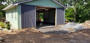

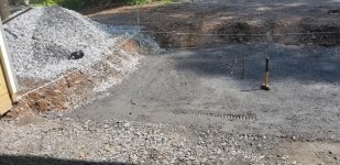

My other issue is this apron. I need to get photos up, but just go along for now... My over-zealous buddy graciously used his mini excavator and dug a hole. A hole about 18 inches deep, 14' wide and 16' long. Why? :headscrat I am still trying to figure it out. In that hole was a really big rock that needed to be downsized, and also a big stump/root system that had to be gone also. This apron pit has pushed me back two months of time, and almost $1,000 in stone. I can share details later how i tackled the rock and root.
How much stone is too much for under an outdoor, six inch thick slab measuring 12'x12'? Assuming it's the correct stone and plate-vibrated in 3 inch increments. I've got about 4 inches compacted but need another 8-10" prior to setting the forms for the pour (after the barn floor pour NEXT WEEKEND)!!

If your 'fill' appears to be well compacted and granular (as opposed to cohesive such as silt or clay), it should be fine to place on. There is no reason to dig any out just to add stone. The concrete doesn't care what it is placed on as long as it's able to provide uniform support.
I'm not sure I understand the reason for the sloped section at the door but your proposed detail sounds fine to me.
With regard to the stone under your apron, place as much as you need. Theoretically, stone doesn't need to be mechanically compacted but it can't hurt to run a compactor over it a couple times while you are bringing the grade up.

I'm going to have 3/4" clean crushed delivered today. The tandem will dump into the pad pit. Today we hand raked the leftover Dense Grade Aggregate over the bottom course of 1.5" crushed rock and plate compacted it down.
For visual purposes i set strings to show the top of concrete. I've got a good foot to come up. Six inch of stone and six inch of concrete. I don't want to worry about a 9000 lb vehicle setting on jack stands. I also envision wrapping around this 11x14 concrete pad, the full width of the building with blacktop.
