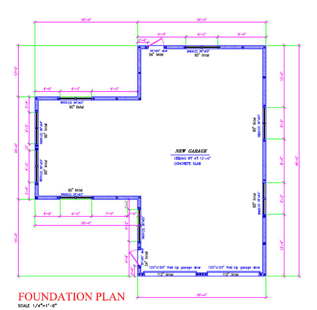

Our idea was to have a four car garage with a shop. Due to property constraints I was forced to go two wide, two deep... which is fine because I will put the boat in the back space, as well as my bikes. The shape of the garage was also heavily dictated by property rules, so that's how we ended up with this configuration.

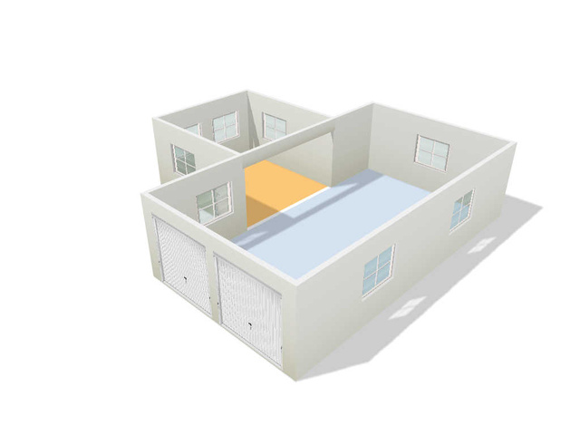

It will be all block construction, 12' walls. I have a 15' overall height restriction, so I am limited to a 2.5/12 pitch roof - but that almost matches our home (ranch style, early 60's, low pitch roof). I put the windows up high to get light into the shop, and avoid me putting tools / parts through them at working level. Dimensions of main garage are 25x45, shop is 20x20. Roof is gable ends - again to match our current architecture.
Here's a rough conceptual 3D rendering:

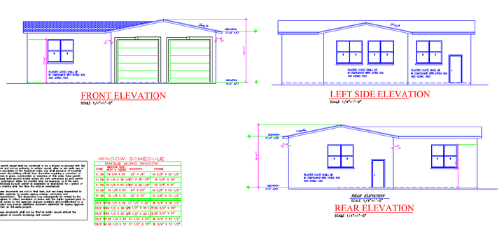

We have decided to go with a single 18' wide door instead, and have moved the man doors around a bit. As well there is no header spanning across the shop area (that was just a hangup on the drawing software). The plan is to build sliding doors between the shop / garage so I can do my work in the shop without coating everything in the garage with dust.
Here's the finished elevation plan and floorplan:
I am homeowner permitting this due to the outrageous markup I discovered when quoting from GCs. I have a good friend who is a GC, but specializes in metal buildings - so he has been very helpful in guiding me through the process! Hillsborough county was remarkably good to work with so far.

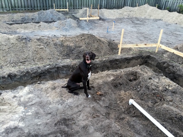

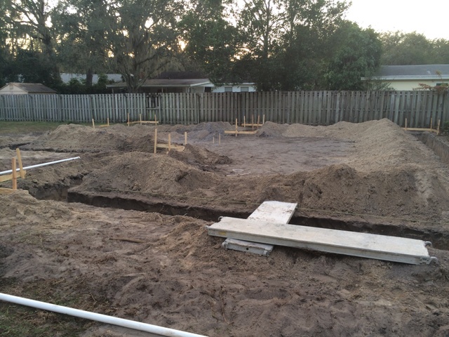

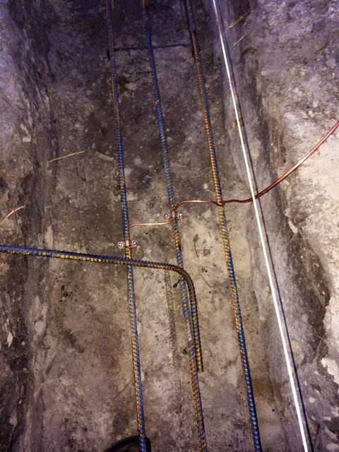

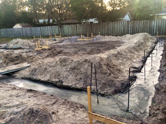

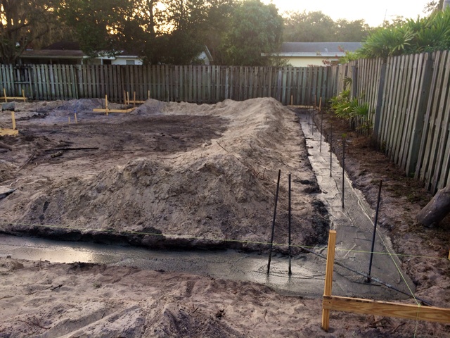

We are permitted and the footer was dug last night. Footer is a little bit overkill, but we have had sinkhole / settling problems in this part of Florida for decades - so we purposely overbuilt a bit. We went 24" wide, 14" deep.
Progress (finally):
Jackson the GSP says "not bad":

Two things:
1. Cannot tell very well form the pictures but what is on the other side of the wood fence? Are the lots back to back or is there an ally/road back there? Reason I ask is if it's a road, it might be nice to have a roll up back there are well so you can "pull through" the garage if need be. If it's another lot, nevermind.
2. May want to consider a small roll up instead of a window from the show out to the yard just in case you are working on say a riding lawn mower and have the car part of the garage full. You would have to move at least one car to get it out of the shop. Maybe replace the window in the shop part that is facing the same direction as the roll up door so a sidewalk could be poured to connect the "driveway" up to the garage to this additional roll up.
Just a thought and easier to do these now rather than later.

Two things:
No road back there, otherwise I agree completely!
Also a good idea. I had thought about this, but it's partially facing the house... And very visible from the living room. Want to keep it as "residential" looking as possible. Thoughts?
Thanks... And please keep the feedback coming!

Hmmmm, maybe a slider with window covering? Not very workshop friendly but maybe some sort of covering so from the outside it looks like curtains but from the inside it's fire resistant at least for stray sparks and such.

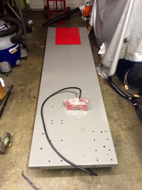

Almost forgot - Santa came early... and he was driving an Old Dominion truck. More fun toys to play with.
The plan is to recess this into the floor, another great idea I got from reading the posts on here. That will reduce the impact on floor space, while still getting the bike plenty high off the ground.
Great looking start to your garage!
With that new lift it looks like you plan on working on some bikes, you might want to check out & post up in the motorcycle garage thread.
http://www.garagejournal.com/forum/showthread.php?t=46792

Haha, yes... it's all bikes at the moment. If you look VERY carefully, you can see a pretty burned up Michelin Power Cup rear tire sticking out from under that cover. About 60 laps (give or take) at Jennings GP.
Nice. No chicken strips there!!!!
I'm always looking for an excuse to take my ol' R6 track bike out for a spin up @ Jennings GP! :thumbup:

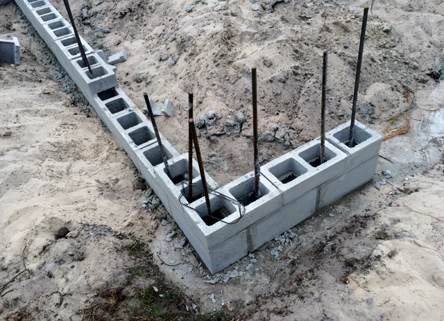

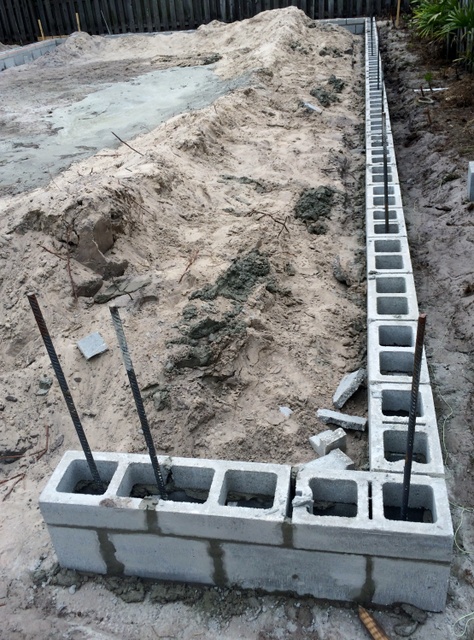

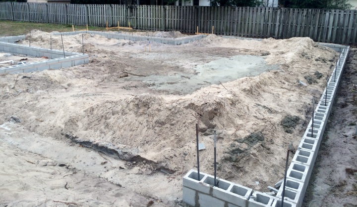

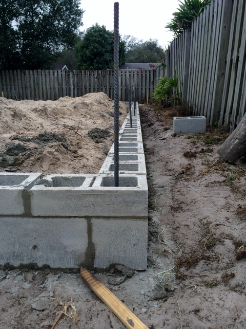

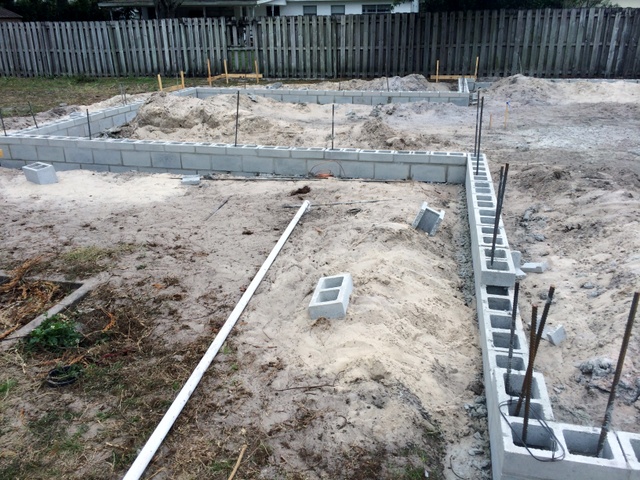

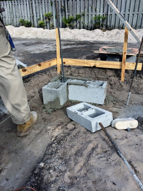

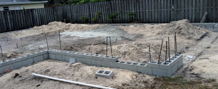

Got the stem wall blocks in this weekend, and had the fill dirt brought in today. A few pics of the stem wall going in:
Literally the first blocks:
More to come later this week!

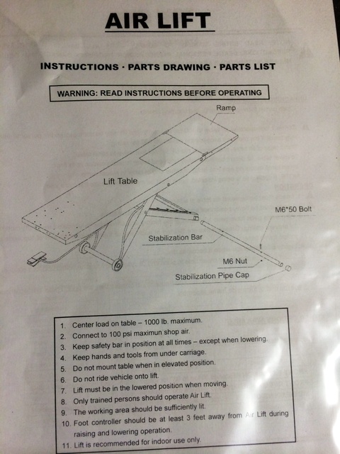

One quick note, you'll see three reliefs in the floor. Two are for car lift "piers" and one is for a recessed motorcycle lift. We're doing 4" 3500 PSI concrete, but we wanted a large margin of error for the lift, so we went an additional 8" (total of 12" deep under the lift posts). The two lift "piers" are 6' x 6'. These "piers" will have four pieces of #5 rebar placed at the bottom of the holes.
The relief for the motorcycle lift will be 1" wider than the actual lift on all sides. It is 7" deep so that the lift will be perfectly flush with the floor when down. We plumbed a 1.5" conduit with a 90* sweep down into the lift recess to run the air line that powers the lift. So enough talking!
Here is the lift again for reference:

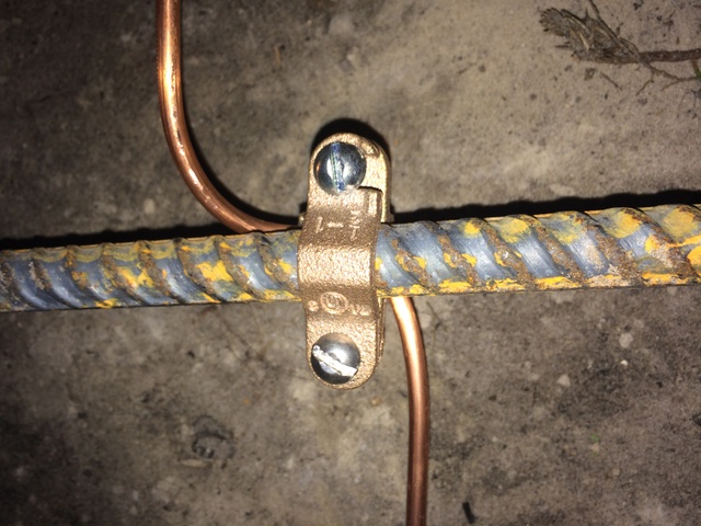

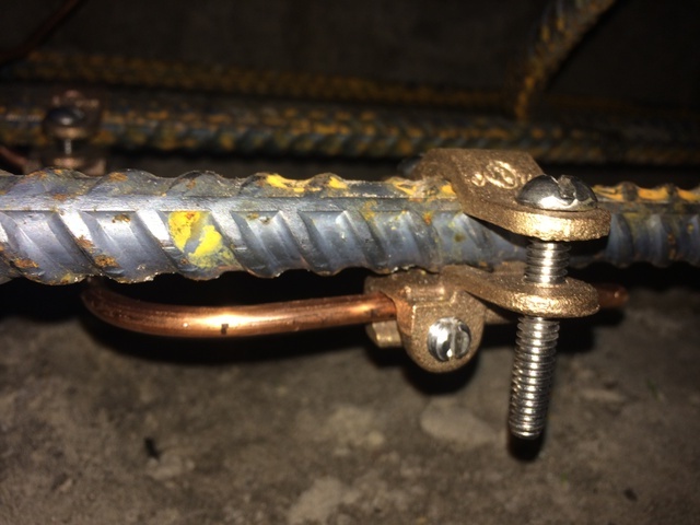

Got the slab inspected this morning and will be pouring Monday! Couple of pictures of rebar in the piers we're building.
First, an obligatory shot with the silly dog:
I'll get some more pics up after the pour!

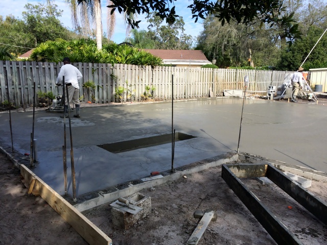

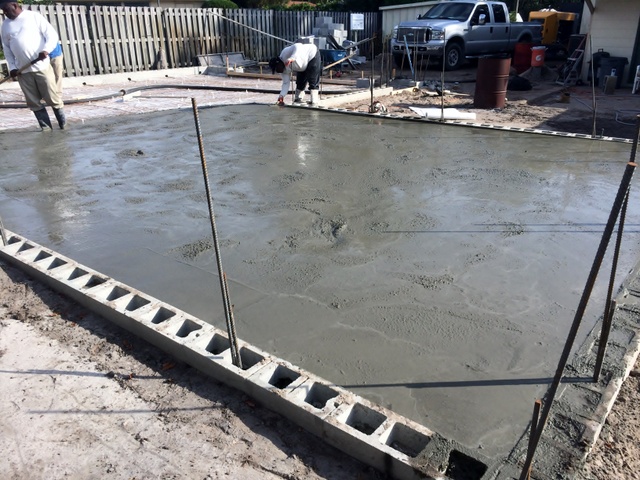

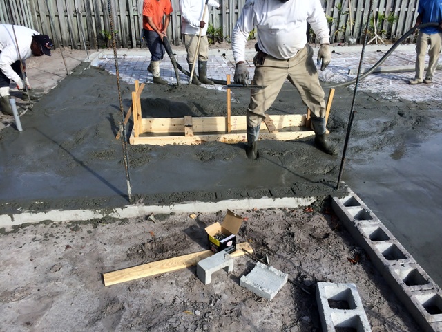

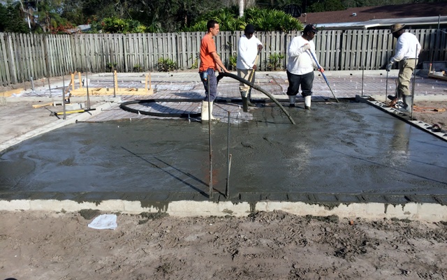

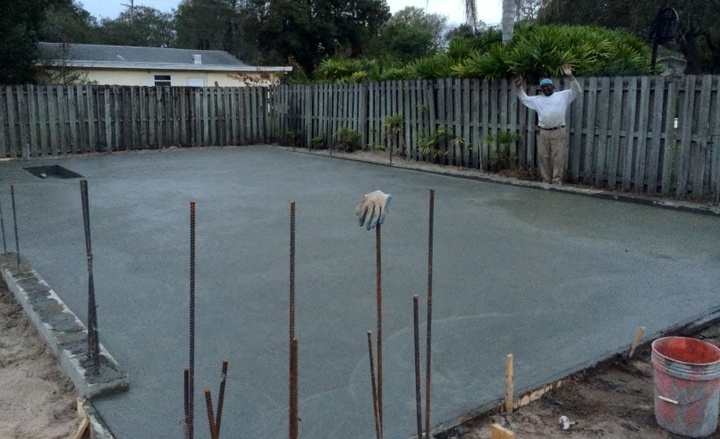

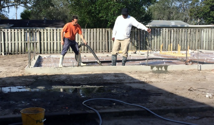

Got the slab poured Thursday. Went 3,500psi concrete with fiber (obviously have mesh down already). Slab went down fine – first batch seemed a little wet – but my knowledge of concrete is very small. We poured every cell of the stem wall solid.
They power finished the top. Went out to see what I had this morning and it looked pretty darned good! They cut the control joints this morning as well.
