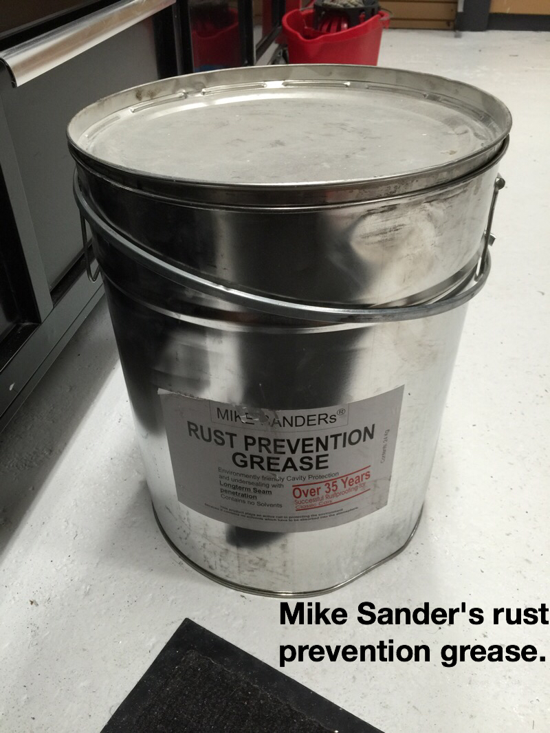

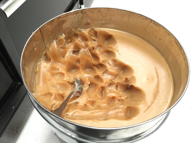

Here are a few pics of both the Mike Sander's grease (which is a good product, but a pain to apply) using a cavity gun wrapped in heat tape. This is a nice gun.
This is the cavity gun above, but not hidden by the heat tape...I really like this one has it has both air volume and material volume controls. It also comes with a really nice compact tip (shown below the gun product image) which does a really nice job of atomising Noxudol. I find it applies much better with less waste.
I've also purchased a variety of long strait wands (great for truck fenders, doors etc), and sprays tips on flexible 3 ft hoses. Both of the guns pictured use the same quick release system. Best place to source is from a local paint shop that sells to the auto sector.
You could also just use a shutz gun (FF tool?) but you won't have as fine control of application thickness..you'll use more product.

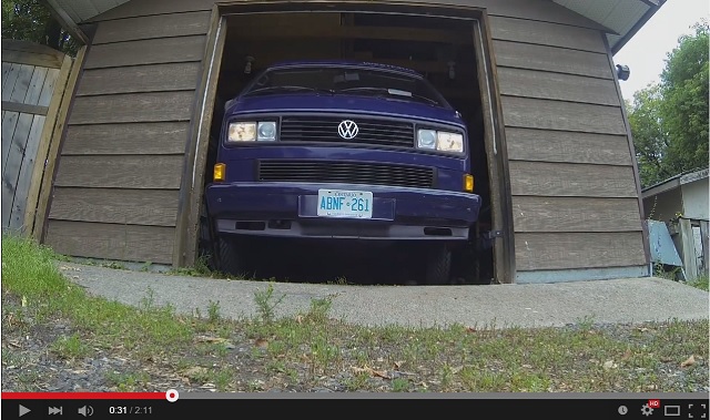

I managed to find the video I used to sell the 1990 Westfalia. It's a few minutes long but shows how nice the van was just before I sold it. Rust prevention is pretty essential for these old rides in the salt belt. It's also a sneak peak of the disaster my shop was before garagejournal made me fix it. Ha.
