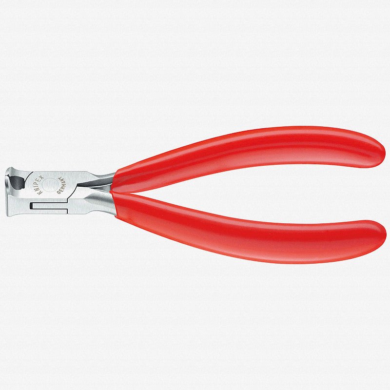

I'm not sure what mine were/are and they'll be buried in a toolbox somewhere, probably at work. They certainly weren't anything special; just a set of carpenters-type end cutters bought from a real tool shop where I could look at what was available and chose the ones with the flushest cut.
The Knipex 72 21 160 look like they would probably get the job done: edges at 85 degrees and offset from the pivot mechanism.

Those 85° Knipex above look nice!
The Knipex 72 21 160 being referenced:

As others have mentioned Knipex has an end cutting plier which may be what your looking for. I have a couple pairs and they work very well when access is limited and only a vertical approach will work. With jaws extending beyond the hinge, the length of the tag end isn't an issue.
They are spring loaded which is appreciated for their intended use but can cause storage issues. I first used a rubber band then migrated to a zip tie like many others have. One small tip which made me smile was turning the zip tie inside out and sliding the locking mechanism between the handles. Nice and smooth without the "bump" anymore.
