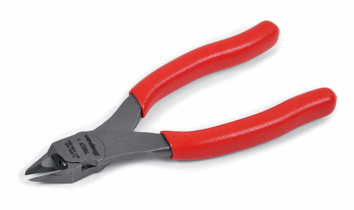

Hey all, so I want to purchase a pair of flush cut pliers. What would be the best option? Mainly for zip ties, small steel cables, etc.
Not too concerned on price or COO. Just want good quality. Not looking for side cutters, only flush cut pliers.
Thanks.

I bought a Matco set, 3" & 6" sizes, they are ok, nothing special. I've had to warranty the Matco's, but they do get quite a bit of use. I did buy a Snap-on 786CF 6" pliers, I think that's the number. They are pretty nice.
Knipex has some decent looking ones as well.
Edit to add;
The Matco's also have "not for steel" marked on them, something to consider if someone borrows them. I think the Snap-on's say something about soft metals only as well.

For cutting hard wire, you will get much more life out of carbide tipped flush cutters like the ones in the quote below. Made in the USA for medical use and they retail for a lot of dough but I picked them up for cheap on Ebay.
There are some good deals on Ebay. I bought a couple pairs of $160 carbide tipped Swanstrom flush cutters for less than $20 shipped. They were supposedly used but they look brand new.
Some brands to search for are Swantsrom, Tronex, Knipex... also Lindstrom, Erem. Check the COO since some of the brands have a wide range from cheap import to high end.

Generally flush cut is only for delicate and soft materials. Due to the shape of the cutting face to get a flush or semi-flush cut, the cutting edge is inherently weak. Staying out of carbide and such, they are all soft. Klein makes a good one that I use all the time for copper and zip ties. I do not have the numbers with me. a little digging and they will surface.

For premium cutters, I recommend the Lindstrom RX8140. I have 4 of these and they are fantastic. They are very sharp, rated for copper wire and are perfectly flush. I have cut small awg steel cable with them and they have done great.
For a budget model (literally $5 on amazon), these Hakko's are awesome. I have not tried any steel wire on these though.

I like the Pro America 4046 5.5" flush cutters. I went through several pairs and have stuck with these the longest. They are the longest pair I could find outside of the crazy price SO gets for their 6" pair, nice thin head and good handles. Like the others mentioned, I wouldn't be cutting any steel with them and expect them to last.

The "plastic only" flush cutters from Snap-on are really nice, but for cutting zip ties it seems silly to spend $65 on a pair of pliers. You can modify an older pair of Snap-ons to do the exact same thing with no effort.

Flush cut pliers cut the zip tie off smoothly. They don't leave a sharp edge that can scratch you. I work on equipment that literally has hundreds of zip ties on it and I consider them indispensable.
I also have the Tsunoda KBN-150, They work well and I think are rated for up to #10 wire. Amazon sells them.

I bought a pair of the Snap-On 786CF flush cutters for zip ties, and really really like them. Not for use with steel wire/cable though.

I recently received a pair of the little Klein D275-5 flush cutters from Amazon.
To put it bluntly, they are absolute ****. Horrible quality control. The blades only make actual contact for about 40% of their length You can see daylight between the cutting edges for the remaining 60%. The blades are not even ground to the same length.
They are so bad I tried to send them back, but Amazon refunded my money and told me to keep them. Threw them in the "junk" drawer.
Spend the extra $5 for the Tsunoda's that M6erfan recommended. They are worlds better.
