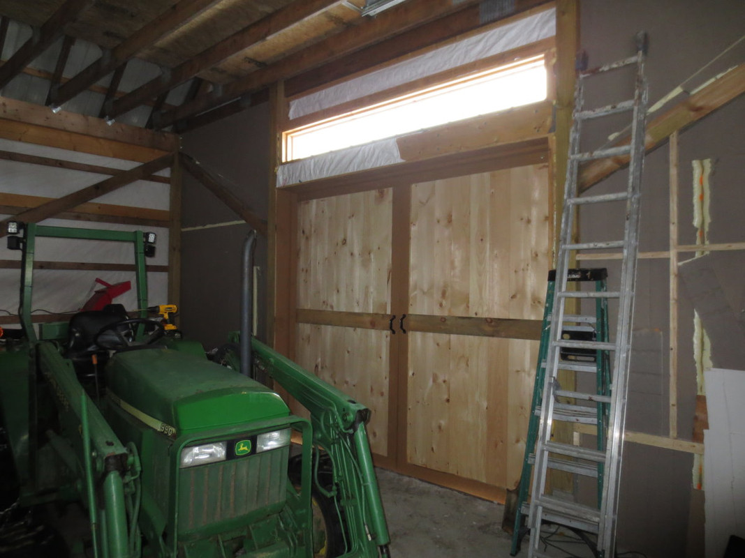

I've read and read and read about this topic and can't seem to find a definitive answer.
I am in the process of insulating my 30x40 polebarn in Pennsylvania. My original plan was to put 1.5 inch XPS foam in between the girts against the metal, sealed at all seams with greatstuff foam, and then I planned to frame a 2x4 wall in between the poles and place R-19 kraft face fiberglass. Then plywood as a wallboard.
Some of the reading I've done makes me question whether I should use the kraft face R-19 vs unfaced. I've read that could trap moisure in the wall as there would be 2 vapor barriers, but I've also read that the 1.5 inch xps is semi permeable as is the kraft paper. Any opinions.
One other question I have is on the first wall I did, I spray foamed all the gaps at the floor and the ceiling where the metal meets the studs. I also sealed the gap where the 2 different color metals meet/trim. Should I continue to seal these? Or keep them unsealed so any moisture can escape from between the foam panels and metal.
Thanks for all of your help!
