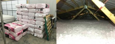

Another vote for blown-in here. I did ~R-50 of blown fiberglass in the attic (with a vapor barrier between it and the ceiling) and R-19 batts in the walls. I am blown away by how well insulated/sealed the building is. My 30'x60'x12' building is in mid-MO, and I'm able to cool it in the summer with two little 6k BTU window AC units. For heat in the winter, I run a 30k BTU propane tank top heater for ~15-30 minutes to get it up to temp, then maintain it with a little 5kW 220V heater.
