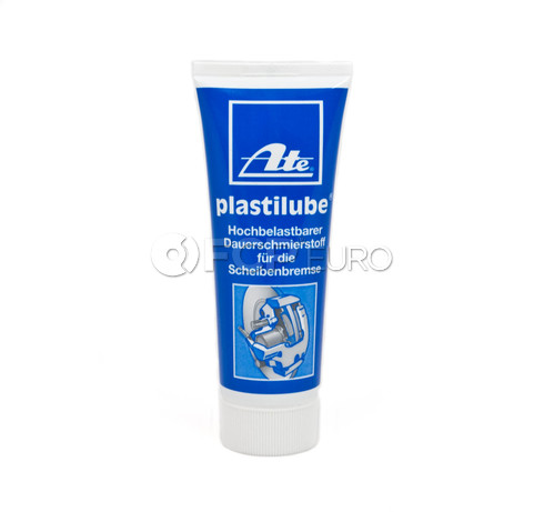

Get CRC Brake Caliper Grease. Brakes get to hot for anything else, it will just melt off.

Most any "caliper grease" will do the job. Sil-Glyde from Napa is a good one
