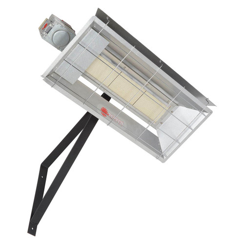

Personally, I would save up a few hundred dollars for a ceiling hung vented heater with a thermostat, and some insulation. You’re going to want that eventually anyway.
