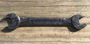

I am sad that it got so beat up…right on the date casting..oh well. Got a service call in the morning so I can’t do anything about further cleaning until later.
That is not a date casting. That is the Federal Stock Number. They made at least 4 of the 5 wrenches in the 5-wrench Jeep kit and they all have a different FSN. If you ever see one with a "41-W-991" casting, you'll be a hero. We like to throw the "unicorn" word around here on GJ, somewhat counterintuitively to mean a very rare tool, but an Arcturus 723 (3/8" x 7/16" - 41-W-991), the smallest of the 5 wrenches in the Jeep kit, has never been seen and may be a true unicorn. :)
...could have been wartime replacements or GMTK wrenches.
Almost assuredly Ordnance Dept spares for the Jeep factory wrenches, Don, and all made in 1945 per the WPB contracts books. I am skeptical of any other wartime applications, including the GMTK, because I don't remember seeing a 41-W-1021 (the 33C), or any other FSN's, either. If you have, please let me know. My notes still show no other FSNs besides the 4 Jeep wrenches.
The company is such an odd little late wartime story, from their name (taken no doubt from the nearby oil deposit and fields where they started in a shed, but also the name of the 4th brightest star in the sky) to their location (Santa Monica, not exactly a current industrial mecca), to their apparently small, focused output, EDIT: and yet, finishing that incomplete thought, they made, arguably, some of the most distinctively shaped and elaborately marked WWII wrenches out there.

I wasn’t saying that Arcturus made a complete set of GMTK DOE wrenches, but all of the FSNs on the Arcturus wrenches that have been found are also in the wartime GMTKs as far as I know.
41-W-1003 DOE Wrench 1/2" x 19/32"
41-W-1005-5 DOE Wrench 9/16" x 11/16"
41-W-1008-10 DOE Wrench 5/8" x 25/32"
41-W-1012-5 DOE Wrench 3/4" x 7/8"
Is there a reason that the Ordnance Dept couldn’t have issued those as GMTK wrenches?
6E629E75-6625-4E81-908C-10C8B0B8F124.jpegUsername’s Arcturus wrench.
30,979
No, or to other applications that used the same sizes. They weren't exclusive to Jeep and GMTK. That 5 wrench set was specified by the QMC as a basic kit for all cars and smaller trucks (except Dodge) before the war. I just find it odd that we've never seen the 33C. I suppose it's possible the Ordnance Dept bought spares for all the wrenches except that one, but I struggle for a rationale for that. You could say the same for the 723, I suppose, but those are always scarcer, no matter the brand, due to their size, so I guess I'm saying there's more of a chance those were made and rare. But, you have a point.
