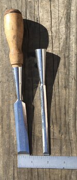

Did some reading and quickly disappeared down a rabbit hole for my entire lunch break. The Kraeuter and the Davies have been mentioned here and there. My questions are: are they really old? Other than grinding the dangerous mushrooming off the end of the longer one is there a reason not to use them? Should these go to a ‘display only ‘. Phase of life?6E7B67F7-BFDC-460F-BBB6-4EE3795DA893.jpegA6DACBBE-BFBB-4E44-8B79-17EFE3AAE70B.jpeg

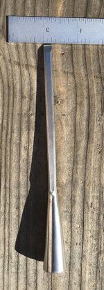

I only just now noticed that I posted the photos upside down 🙃…sorry. A reference in Alloy Artifacts (sometimes right) calls the Kraeuter a wood chisel… I don’t know, never owned or used any before, I’m a metal wrangler, don’t mess with organic stuff much.076C8506-872A-4DEA-8FD2-C07093EE32D4.jpeg076C8506-872A-4DEA-8FD2-C07093EE32D4.jpeg

Very interesting wood chisels, you have there.
Some more information for you on this nice wet night.

Several companies made those all steel wood chisels. Made for rough work where you can really pound on the head without breaking the handle.
13,246
Wonder if the original chisels are symmetrical or asymmetrical. If symmetric, I would think cold chisel. The AA ones are asymmetric, so I could believe wood chisel.
my couple of all steel chisels have all the trappings of a wood chisel, bulbous handle, etc, not just a straight shaft.

Those file handles are owner made wire whippings and they look great! I'd like to see a shot of how the wire ends are terminated. It looks like they are soldered.
I have an older thread on wire whippings here: WIRE WHIPPINGS
Please post some photos of your whippings there. I've also got some more interesting details of whippings I need to add.
The alloy artifacts photo of the chisel shows a light curve of the front shank which is how wood slicks are made (if you hold the tip down flat on a flat surface the handle raises up off the surface). Another interesting thing about slicks is that they most commonly don't have beveled blades, just straight edges. The ones being made today are found both styles (beveled sides and straight sides).
I also have some craftsman all steel wood chisels I'll dig out and post photos of.
I wouldn't hesitate to use them myself.

I will clean them a little more and take pictures tomorrow evening. Many Thanks for the information..
