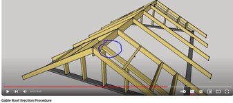

Hi GJ,
I am getting ready to attach the flying rafters then the outriggers then the verge plate. I am following along in a YouTube video called “Gable Roof Erection Procedure”. I plan to use a Simpson VPA4 at the bottom. This is for a shed in FL on beachside/hurricanes, so there is a lot of strapping and brackets. This is first structure I have built and I am learning along the way.
I am not sure how I will attach the top of the verge plate yet to the ridge board. I may drill holes through the post cap holding the ridge board then toe nail the verge plate. I called Simpson to ask if they made a connector to attach the top portion but their engineering dept. was unsure, they said they would call back 1+ week ago but never did. I will call them again.
Is there a better method to attach the verge plate or a better way to build the front gable end? Is it called a verge plate? Another internet search showed this might be called a raking top plate.
I will start the front in 2+ weeks since next weekend in Easter. Thank you in advance!

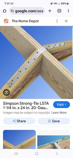

Youngandfree
Dec 29, 2020
877
VA
What if you just run a strap like this
I did strap all the other rafters as shown in the pictures. I left the rafters high to leave a gap for the ridge vent at the top.
why not just throw another rafter in it's place.
I bought another rafter bracket to see what it would look like installed. I would have to install a wider shim on both sides and swap out the hex head wood screws for nails to make it protrude less or relocate the holes. I would leave the black colored ridge beam screw in the middle.
I appreciate the input (y)

Youngandfree
Dec 29, 2020
877
VA
Put the strap under the bottom since the board isn't going to the top of the ridge.
