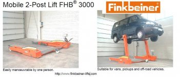

Probably not what you are looking for, but this is free standing and reaches in just like a typical 2-post with arms to allow full access underneath.
They were pricey last time I checked and I'm not sure if they are available in the States yet. I still kinda want one though.

I've also been looking for something like that, but havent found one. I'm surprised there isn't one available, specially after seeing that one post lift.
Nevermind, that orange thing is perfect. I bet I cant afford it.
