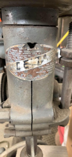

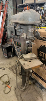

So I have a friend who is cleaning up his warehouse and offered to give this to me as resto project to do with my boys. I have never restored any old tools, but a free press seems like a decent place to start! I am going to look at it Monday, I don't know much about it other than it is 3PH so I'll need to add a VFD to it to run in my shop. He also said he stopped using it because he got tired of the chuck always falling off, not sure if that is a warning sign I should be leery of?
Any good spots to research these? I don't have the model # yet, so I'll have to wait to do any serious digging until I get it tomorrow. Any info you guys have would be awesome! I just noticed as I was posting these pictures what appears to be a hole in the casing behind the tag, something to be concerned with?
**Edit** Researching now it looks like a Delta Model 17

Great tool for great price! Now you have to continue this thread so we could see the progress
Congratulations!
Tarnished
Feb 8, 2012
721
SW Ohio
Juiced: Nice old Delta 17" drill press. Will clean up nicely and should make a great press for the next 70 years.
For information on restoration check here: "Old Wood Working Machines.org". Plenty of restorations and rebuild information on your drill press. Let us know how it goes.

That DP looks to be an excellent candidate for full restoration.

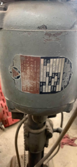

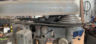

Appreciate all the feedback guys! I went and looked at it today and grabbed a picture of the serial tag. The SN is 94-7953, which puts it at 1951 from what I can tell. Other than being grimey, it appears to be in really good shape. There are no missing teeth or anything on the table gears that I saw, and everything appears in tact and the table is not all drilled into. It only has a single pulley on the motor right now, not a stepped pulley like I have seen on others, so I am assuming it was changed sometime in the last 71 years. I like the idea of a vfd so I can have the variable speed control. As far as finding a larger motor, if I were to go that route I'd probably just convert it to single phase at that point. Would finding a larger 3 phase motor be just as difficult as finding a single phase with the correct bolt pattern?
It may be a bit before I get around to restoring it as I need to finish the shop first, but I'll keep researching in the meantime and keep you guys updated!

If I were you, I'd start looking for a motor step pulley. The great thing about these old Delta machines is that parts can generally be found. (Ebay or OWWM.org Boyd forum). The guys on OWWM are very helpful with parts.
I'd keep your existing motor for now. It looks original to the machine. Just order a Teco L510 110V 1HP VFD. Your old motor might be 1/2 HP? It's certainly usable but might not be powerful enough to drill large holes in steel at low RPM unless you select a lower belt range. The beauty of 1+ HP motors is you almost never have to move the belt from the highest speed setting even for large/slow drilling. Adjusting the VFD is all you need.
Over time you could look for a larger motor if you want depending on how you use the machine.
These machines are pretty straightforward to restore and the end result is worth the effort.
