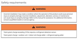

So I have a rent house with an r22 system from like 08. The capacitor went out, so they fixed it and charged me $400 when I probably should have just replaced the whole system, but I guess you never know. It could go another 10 years. Anyways, are these new hvac systems really that sensitive and problematic with these new freon leak sensors? Couldn't you just unhook the sensor and keep it outside in clean air for lack of a better word? Lol Talking to the technician it sounds like even a brand new hvac system they're detecting leaks. Not sure if that's just a faulty sensor or if they're really sensitive.

... with the new flammable refrigerants.
That's what it's all about. A2L is what's in the cards post R410a.
The problem I have is that flammable gas sensors will pick up on ANY hydrocarbon gas. Aerosol sprays used nearby - alarm. A little gas escaping your stove burner while lighting it - alarm. Fart in the wrong place - you see my point. And these sensors need to be set to pick up very low concentrations, in the off chance that a large leak is far from the sensor.
At least with R600a (isobutane) systems, the workaround to a sensor is simply keeping the refrigerant charge so low that it's not considered a big risk. But isobutane is VERY flammable, while R32 (I think this is the future of A2L) is hardly more flammable than R410a. On that alone, I'm all for waiting this out as long as possible.
I haven't really looked into it. I was assuming that the sensors would only be required on systems containing over "x" quantity of refrigerant.
BrandonV
Jun 9, 2023
4,030
Arizona
ASHRAE Standard 15-2022 does call this out.
Anything over m1 generally needs to have a leak detection sensor minus a few exceptions to the rule.
Most units will call this out in the installation guide.
I'm pretty sure most hvac systems hokd more than 3.9 pounds of refrigerant. Mine is a 3.5 ton. Nit sure what that would hold exactly. They makes it sound like the sensor is an external add on that can be left off.
Yup. It's more of a generic warning I assume York throws in their manual.

I think your technician was talking out of his ****. I have installed a couple dozen new systems in the last two years and worked on a bunch of older ones, none of them have any sort of leak sensor that constantly trips. I have never heard of that as a real issue. If they are leaking enough to trip a sensor either the sensor is defective or the system needs repaired.

I've installed probably a dozen or so Bryant systems with 454b, can't get 410a systems in many sizes right now.
The leak detection sensor comes mounted in the coil and plugs into a simple box that gets mounted nearby that connects to the furnaces low voltage wiring, if it detects a leak it will shut the furnace or A/C off and run the blower for a period of time, once it sees that it's all clear it will reset.
If it were to fail it could be bypassed pretty easily.
Lennox uses basically the same thing, I have to do the A/C side of an r32 goodman next week and think it very similar as well.
As of right now most manufacturers except dakin/goodman/amana are using r454b, goodmana went with r32
Well that's reassuring. Probably not any different than a float switch for the condensate drain pan. I mean I'd imagine it's just a switch if it can shut down the system
