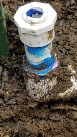

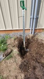

I'm not sure if that is the name, but it had a below ground drop release that empties the pipe.
So my contractor pt one in, put a stake next to it and wrapped a flex tie to the stake.
The second time I opened the faucet I must have applied a bit of side torque, the pipe broke off. Now the house water is turned off while I repair this.
Any suggestions on supporting this better?

Not an expert, but PT 2x4 (or 4x4) into cement, and stainless pipe fasteners to the PT lumber?

They are designed to be under the frost line? So you end up with 3' in the ground for support
Google the install.
We are not allowed have them in my township -- they can be on a farm.
They need to have a stone drain ..... if the ground water is high enough when the faucet is off the pipe is open to the ground water ... if contaminated this water will be delivered to the tap.
They make a type you can install --- google Murdock hydrant

Obviously the contractor didn't have a clue. What is your frost depth? Here in Iowa the metal pipe and valve would be 4'+ in the ground to get keep from freezing.

Thanks for the replies. I was out repairing the line to get water back to the house.
So I added used brick under and around to add some support, then poured 3/4 minus to fill the spaces, then more 3/4 minus to the surface, and filled the bucket with 3/4 minus. Tamped dirt and rock down all around.
I'll get u bolts tomorrow, maybe pound that T post in more too.
I appreciate the quick responses.
I live close to the lower Columbia River, a banana belt compared to you central and northern folks. It rarely freezes hard here, maybe 20° for a few days. It does rain. Often.

The hydrants like that I see in Minnesota are only supported by the hydrant itself. Here they need to be buried about 4 feet deep so there is plenty of support in the ground.

The PVC and the shallow bury depth are definitely the failure points. I can't count the number of hydrants like that I've used in my life and they were all solid as a rock. I've tied horses to them countless times.

Stainless steel hose clamps or u-bolts would hold the hydrant to the t-post.
+1 bury deeper, gravel at the bottom and brass elbow.

I would lengthen and bury that horizontal below the frost heeve, and then extend an additional uni strut to Mount the hose bib to.
Uni strut has lots of different choices, like a 90* piece, that will allow some off the wall mounting options.

I would never attach a farm hydrant directly to abs or PVC. Put 4 feet or so of galvanized on each side of the hydrant and bury the pipe five feet underground

With your climate you could do what we do in the South. Dig hole, few shovel fulls of gravel, place hydrant and brace it temporarily, add some more gravel, then place some plastic sheeting or at least a layer of dirt, wrap the pipe shaft with tape, add a couple bags of Redi-Mix concrete. Make like a collar of concrete at least two feet wide and 8 to 12" deep.
Only disadvantage is if you ever need to pull it out you will need to tilt the collar of concrete out too. The ones I did years ago with PVC pipes are still doing fine but the last couple had PEX lines to them and should probably be even less of a problem.
