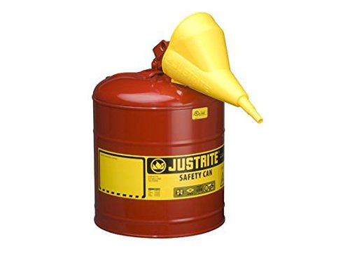

I have one like this. Nothing to dislike about it whatsoever. The funnel folds down when not in use.
The funnel will overspill, if filling a larger tank quickly, but, but it is designed to cut the end off to make the opening larger., if desired.
+1 on these types of cans! The justrite seems to be better than the eagle in my opinion. I love the ones with the flexible metal nozzle. The yellow plasitc funnels on the eagle ones tend to break near the neck. The D.O.T. approved versions are top notch as well. The NATO style jerry cans are great. I pass on the old G.I. style ones. I dont like the large round threaded hole for filling and needing to screw on the nozzle. I will never use the plastic **** again. :thumbup:
