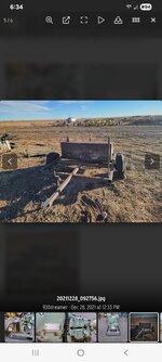

I bought a stuck Lister diesel genset years ago (it's still stuck) on a single axle trailer with a fuel tank. I'm thinking about re-purposing the trailer just for fuel. I wonder about a single axle and the center of balance?
10 percent should be on the tongue as a good rule of thumb. So find the center of gravity and move it forward to get the 10 percent. \
Remember that 119 gal is the max in one tank or you have to have a hazmat license. You can have multiple separate tanks as long as none of them have more than 119 gal individually. and the total is under 1000 gals total if I recall correctly.
How big is this tank? Those Listers are real fuel sippers so I'm guessing that the tank might be smaller. Sorry if I interrupted your question as using the existing tank.
9
930dreamer
Oct 7, 2009
23,125
Amarillo,TX and Stinnett,TX
This is how I found the trailer configured. I'll have to see if there's a tag on the tank. Not sure if this would be the tank I'd use. It's use would be on my property only, gas station is a mile away.

I built one for the day job and centered the tank over the axles. It's on a tandem axle trailer, tank is a 150 gallons and tows relatively fine behind a 3/4 ton truck.
