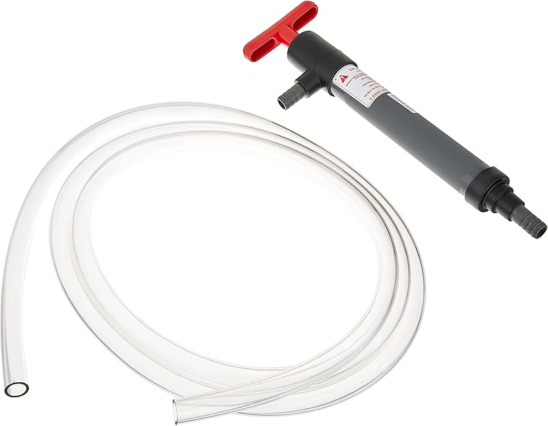

I have a hand pump / siphon I have used occasionally for years (maybe once or twice a year). If the source tank is above the destination tank, you just pump a couple times and then the siphon starts and it goes pretty quickly because of the large tubing.
https://www.amazon.com/dp/B00JGX2H2Q/?tag=atomicindus08-20

I use a jiggle siphon pump to transfer fuel. These are cheap and require no maintaince . All you need is the fuel can to he higher than the tank you are draining into.

This is a Amazon screenshot. I've have both hand and the 12v versions, you can also get them with a rotary hand crank as well. The ones pictured should do gas and diesel. The volume you are doing you will never wear them out. You can also buy rebuild kits. I have one I got a rebuild kit for just because of heavy use not from any issues didn't show any wear upon disassemble. New parts did make any noticable change in fill rate. I have a meter in that pump, so easy to see volume being pumped. That pump has ran well over 50,000 gallons in red dye fuel.
For your use one of the hand pumps on a larger tank would work great. 5 gallon cans not so much.
