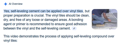

Moving into a new shop and there are really stuck vinyl tiles with currently 1/4" room for self leveling cement floor. This is not a heavy use area - just basically an entrance to walk on. They are not peeling at all and are superbly stuck- cant even get a hand scraper underneath- it would require near jack hammering to remove.
my one thought was the vinyl wd be a great moisture barrier and due to the roughness of the scfribed carpet glue would aid in the cement keying and grabbing a hold. i would 1/4" would be sufficient for light use?
I would use a primer over the top first-
AI agrees?

Don't confuse self-leveling overlays for indoor flooring with polymer-modified cement overlays. Self-leveling overlays, like those sold in home improvement centers, are not intended as a wear surface and can't be sealed or coated. It's one of the first sets of limitations listed in the technical data sheets.
Some self-leveling cement products, such as Ardex, can be applied over vinyl tiles. However, it requires scuffing up the surface to remove all glues and other contaminants that the cement won't adhere to. Read the technical data sheets for product installation carefully and call the toll-free help line if you have questions.
