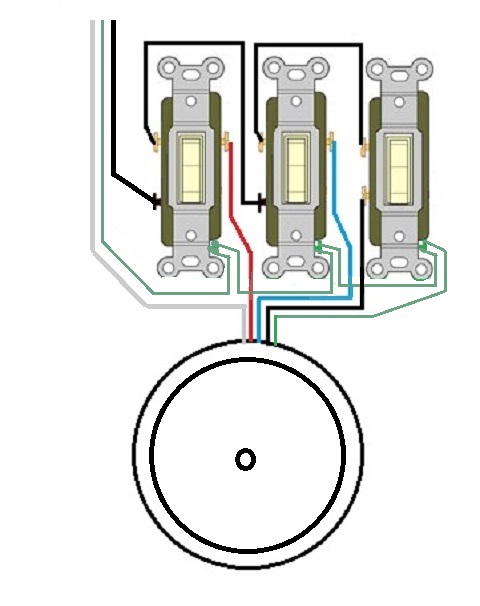

You only want to energize one speed at a time. You could use two 3 way switches and a regular switch to set up three switches. The first one gets power on the common terminal and one of the others go to the motor. The other non-common terminal hooks to the next switch common terminal. Again, another terminal goes to a motor connection and the other non-common terminal goes to the last switch. The other terminal on the last (standard) switch goes to the remaining motor terminal. Or, probably better, you could use a standard switch first in line for on/off. Then two three way switches to direct the power to one, and only one, speed connection on the motor.
So if I understand you correctly it would look something like this.
After actually drawing it out & getting a visual image of the switches wired up, It looks like it should work!
Doug

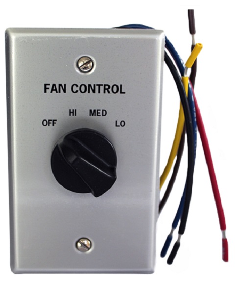

this would work! but by time you buy the 3 switches an enclosure and cover, you're more than half way to the rotary switch that is motor duty rated!
stingry
Oct 14, 2006
736
Western Nebraska
Yeah something like this one would be ideal
But they cost about $40 & I already have some wall switches on-hand.:rolleyes2
Doug
Ebay has a bunch of rotary switches. Search 4 position rotary switch. I bought one to do exactly what you are doing. It was only 7 or 8 bucks.

as far as utilizing those 3 way switch... it's just ensuring only one of the wire is on... if you work through the logic... from left to right. say A (SPDT) B (SPDT) C (regular on/off)...
A ON.. no electrical to B and the screw on the terminal to the fan speed 1 is energized., if A off, Electrical is to B, screw terminal to fan speed 1 is de-energized.
A off, B on screw terminal on B to the fan speed 2 is energized. .... and so on so forth..
A off, B off and C on terminal to fan speed 3 is energized.
If A off, B off, C off then system is off...
it's weird logic but it's stepping though one by one with switches.
