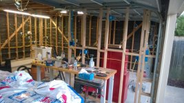

After being in my home (purchased new) for almost 10 years, I felt it was time (and with a lot of positive pressure from a good friend) to overhaul my unfinished detached garage.
Over the years I had made accommodations in the unfinished space, but I had always known those to be temporary. So I refer to those minor improvements as Garage 1.1, 1.5 etc.
The name “Garage 2.0” - this is the starting over and doing it exactly as I want.
I've now put about three months into the project, but working full time+ and doing all of this work alone on weekends and evenings, I guess I am good with progress / timing thus far.
Along the back of the garage, I have built a 4 x 12 lean-to. Originally, I planned this to be smaller (4 x 4 or 4 x 8). It houses my air compressor and vac. I then thought to make it 12' and also use it as a "parking spot" for the mower and outdoor equipment. This works well since the compressor and vac are stationary fixtures in the back of the space.
I began this project in Sketch-Up and drafted a general idea of reworking the space, yet much has changed in what may be considered a “design-(as-you-go)-build”
I mentally split the rebuild into three phases: I – Lean-To build, II – everything “behind the scenes”, and III – completing the interior build out post drywall.
Phase I and II are coming to completion as I set out to start and complete drywall over the next week that I have taken vacation. I see questions from time to time such as "what all should I do / add while building my garage / shop. The following list details everything that has gone into phases I and II that I wanted:
