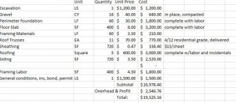

Here's how I think a general contractor will bid it, rough numbers for an urban area:
Looking at it after I posted, I left off the roof sheathing, which would add $200 or so more.
Updated my cost sheet for what I'd guess at for doing it yourself, except for the concrete:
Those are reasonable numbers, incl. sales tax.
