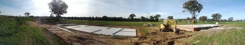

18th March 2014
So an update is in order...
Power:
We've chosen our electrical provider, and they should have the power meter installed sometime this week. Hurrah for the first step. This lines up with the second step...
Garage:
Garage has been ordered and paid for, and should be delivered in 4 weeks. 15m x 7m, two double-door garage roller doors. Woooo yeah. That makes me happy.
I'm getting the power ran over to the garage then having a breakout board over to the house.
This means when we get a solar installation completed on the roof of the garage, a mains board is directly underneath. Making it easy to connect etc etc...
House:
Footings have been poured, and they're now bricking up the base in order to fill, then pour the concrete floor.
Apparently it will sit for ~14 days to cure before they'll come back and begin the polish/burnish. Once that's done, it's full steam ahead to put the frame up, the building wraps and windows all go in!
First brick layed!
Septic / Water System:
This has been delayed, not by any bad stuff, just site access etc. The concrete truck needs to be able to drive around the entire garage/house. It's only got a 4m boom to pour the concrete, so they want to be able to drive it around all sides of the slabs....
The 110,000L water tank sits close to the back of the garage... hence why it's been pushed back a bit.
It also means the septic can be set at the right depth once they know the height of the house. It sound a bit confusing, but it'll all work out.
While they're waiting for the concrete slab to cure, the septic/water tank guy will be out there setting the bed for the water tank, and digging the hole for the septic. Means he's the only one out there, he's got the site to himself and he'll be happy.

We didn't see the slope across the block, especially up where the house is located, but after they'll finish bricking, apparently we've got nearly a meter exposed of the brick foundation showing on the low side near the garage.... However, the dirt in front of the garage is to high, so that'll need to get scraped back.
AKA, I've got no ****** clue how I'm going to sort out my driveway ;)
We'll just have to wait and see how it all ends up, and figure out the driveway and stairs from house to garage when we can actually see what we're working with.
Fun times. I'm just so glad it's moving forward and it's no longer just some exercise on paper.

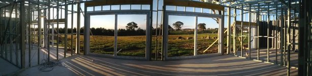

12th April 2014
So, time for another update.
Windows: Windows are on schedule, and we've gone and talked to a guy about blinds for the double glazed PVC windows. We're ordering blockout blinds for the master bedroom. I'm working shift work, so I need to be able to sleep in the middle of the day...
House: In the last update, we had foundations and brickwork. Since then, we've had plumbing installed, and they'll be getting ready to pour the slab shortly. We just need some good time without rain! Goddamn it, it's been delaying us at every turn.
It's such a titanic struggle against the weather *hur hur hur!*

LordDiesel: Thanks for the comments. I've taken a nice panorama photo showing the view from the house, I'll upload it in a few days.

Okay, Update time!
House:
Both the shed and house slabs have been poured. We've had some minor surface cracking on the house slab, nothing structural. It's to be expected, it's concrete.
Neither Karyn or I mind, it'll add a bit of character to the floor, and the locations will mostly be hidden under the internal walls.
The house slab has been curing and it'll be start being polished by next week then up goes the frame! woo. It'll be nice to get back on track!

What the? Full frame up and the window company came out to install the LAAARGE window frames. They'll big sliders, and they have to be set perfectly level so they slide properly.
[pix]qsice[/pix]
Panorama showing the view from my big windows. :p 2.7m high, 3.6m wide per unit :D Thats a lot of glass, god, that'll be heavy... :\
