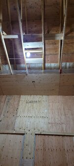

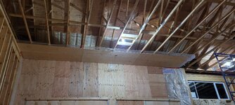

I Switched gears a little today and with some help from my dad we got the 1/2in plywood up on the east wall in the tall section.
Even with the scaffold getting the plywood all the way up a 18ft wall was a tiring work.
Being in the cascadia earthquake zone it was in the back of my mind that those tall walls were at risk of sideways sheer motion, but with 1/2in sheathing on the outside and inside of the walls holding everything squarley together I feel a lot better about the structure now.

After recently tearing down a wood building (and spending a lot of time retrofitting commercial buildings for earthquakes) I now know why we stick build on the west coast. In an earthquake, wood is good.
For sure!
In addition to the plywood interior cladding I made sure the engineers on my building included the walls all being bolted to the foundation a bit more often than code plus earthquake straps, enlarged footers, and the rafters are all hurricane/earthquake strapped to the walls. Still i'm not sure it (or most structures) would withstand a high magnitude earthquake without damage but hopefully it makes the difference between some repairble damage and a collapsed structure. Hopefully, I don't experience a major subduction earthquake in my lifetime.

I've also started the vapor barrier and 3/8 ceiling plywood (I don't see an advantage to thicker plywood on the ceiling). note the future door opener plug box. Additionally I extened the sofits ducts up to 30in of height above the bottom of the trusses as they are only 20in before (not tall enough) and stuffed 8in x 24in strips of Roxul my neighbors gave me on top of the walls but under the sofit ducts (had to be careful not to crush the ducts!) The Roxul strips will stop any blown insulation from falling into the sofits and should also stop and wind guests from messing up the blown insulation.
I need to get at least the first 8ft of the celing clad with plywood before my doors arrive but I couldn't go further than 4ft until I made a decision about lighting...
Being that I have 18ft ceilings in the tall area I thought my shop is a decent cannidate for High bay lights. I got these two from Rona they produce 15,471 lumens each (about 31,000 combined)
I honestly don't know if that will be enough light but if it is it will turn out to be a very inexpensive lighting solution and also very simple since I can just use the two existing ceiling light electrical boxes. Additionally they hang down from the ceiling with a chain which perfect as my one electrical box is situatied between where the 2 12ft garage doors roll up so the light will still be visible even when the doors are open.
So basically i'm going to put up some plywood then the high bay lights and then judge if its enough light, if not i'll add some more boxes before completing closing up the ceiling.
I also added the blocking to hang the high bay light on my light box near the 12ft doors
