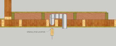

So slab has been poured, I expected better but more on that later. Still working on resolving the issue above, and have ran into another.
I started stud layout and wouldn't you know, plumbing drain line is exactly in the same spot as a stud. I measured 4 times when laying out the plumbing so it would land between studs...
Stud layout is the same regardless of which end I start from, so how does one go about framing around the 2" drain line? I haven't been able to find any examples of this online.

Right so stud on both sides. It's load bearing and happens to have a roof truss landing on it.
Here is what I'm thinking. Stud both sides 3" apart, 90 the pipe one into open stud bay and take vent up through top plate. Fill in 3" gap above 90 with two "blocks" to transition load to the 2 full studs.
Sheathing happens to also land here, so I could start with a half sheet which would shift the edge.
Would you put a metal nail guard the width of the 2 studs vertically to protect the pipe until it transitions?

Will vent need to be 2" or maybe 1 1/2", making it easier to drill through stud above T. Then just header it off and put stud above header back on 16" spacing.
If it has to be 2" all the way, a Simpson Strong-Tie Stud Shoe might help.

Drain has to be 2" to the stub out, vent from there I believe can be 1 1/2".
I may have an odd solution, this area is a double wall and the studs are off set. If I put a "dog leg" in the drain and take it into the other wall cavity I can then go around the outer stud and not have to bore any holes. From what I can find in the code a "dog leg, jog, kick" whatever you want to call it is ok as long as its below the lowest fixture drain. I did a quick sketchup to illustrate, hope it makes sense, if I'm thinking wrong please let me know.

After looking at it for a minute, I could just stub out the 2" right where it is and then dog let the vent out through the other wall cavity... its just a wash tub in the garage so the location being off a few inches isn't critical.

I think you can't use the sharp 90' on the drain. OK for vent. But your second solution with a sanitary T and then 1 1/2" vent is fine.
Right, I would use 2 long 45s for the kick vertical, sani tee to go horrizontal and long sweet 90 to stub back out the wall. The 2d drawing makes it look funny.
But you're right, just sani tee to stub and then vent is much simpler.
