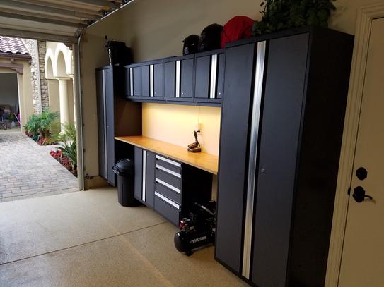

Mount 'something' at the same elevation as the 2x plate and set the new stuff on the 'something'....maybe a piece of ¼" flatbar, drill the end of the flatbar, attach to the 2x plate and set the opposite end on a piece of pipe/sq-tube/2x4/brick/rock... Set the new stuff on the flatbar. Can't hurt to have space under the cabinets.
Croixboy
May 28, 2014
37
Lewes, De
Place cabinet on top of 2x6 and extend front feet to level. If front feet won't travel enough to level then place a 2x6 under front feet.
astroracer
Jun 22, 2005
3,001
Mid_Michigan
If you look at your pic you can see the far cabinet is sitting on top of the footer, as are the rest of the cabinets, just like your shop. If you set the cabinets right on the footer simply run a few screws into the wall studs to attach the cabinet to the wall. This way you can just let the front hang in space.
I did this same thing with some shelving units in my parking garage. Set the back feet on the footer and ran a few screws into the wall studs to support the shelves. The front legs hang in space. They've been like this for 20 years with no issues. :)
