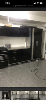

Its not the best picture but that is similar to how I mounted my NewAge cabinets. I wanted to be able to easily sweep underneath them (or fill that space with stuff!). I rested them on the small concrete ledge, bolted them all together, and used 4 or 5 of the course thread lags right into the studs.

Well done! Looks beautiful. I'm guessing that the process worked out well for level and plumb? I have awning windows in our garage. Like yours they are high enough off the ground that deters break in through the window but allows great light (east facing) and ventilation.
