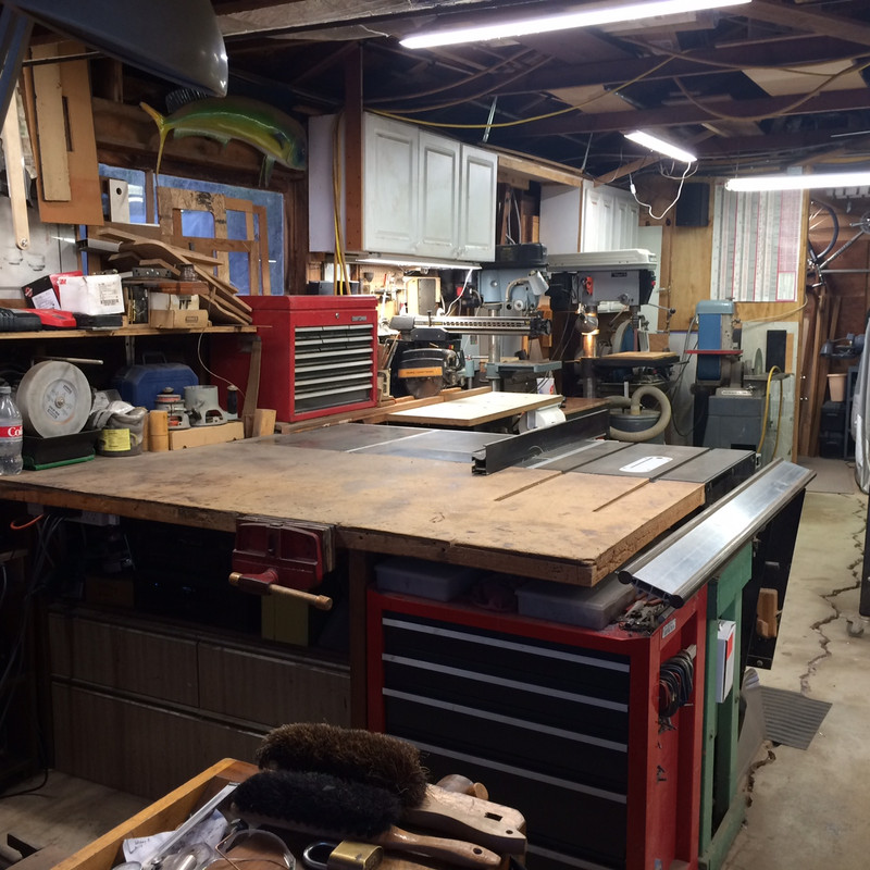

My woodshop storage is Craftsman, the red/black color which I bought at various times during sales at Sears. I have the workbench with two under-bench cabinets, three tall cabinets, two tall 48" wide shelf units and two small 3-drawer tool chests. I also have a small work area at the front of my garage which has a workbench with drawers I built and a small rolling tool chest.
Image from Internet
