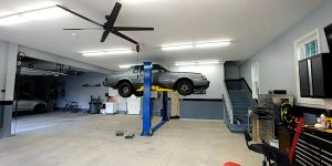

Anyone have a recommendation for a garage ceiling fan less than $400?
I'm finishing up insulating the garage and have an infared heater and 12' ceilings. While installing the insulation at the top, it is noticeably warmer at the top than on the ground (big surprise). Its a 4 car garage, so I'm thinking I need a bigger one or 2 fans.

In a 4 car garage I would recommend at least 2 fans. In the 30'x26' 2 car section of my 3 car (12.5' ceiling) I have one 64" fan that was a display model at Lowes. They were replacing it with a newer model and I got the display for $50.00. It helps in the summer, but even on high I was hoping for more airflow than this provides. In a larger space, I think two fans would be more effective. In winter, on low it does help more evenly distribute heat from the NG unit heater.

I’ve got a pair of 52” fans in my 28x30 with 14’ ceilings. Keeps the temp very stable year round.

In my point of view, we can have a 52' to 60' ceiling fan for 4-car garage. It should give the ample ventilation in the workshop. Another question is your garage bright enough? If you already have ample shop lights, we need to make sure that the ceiling fan doesn't have lights on it. It is usually cheaper.
