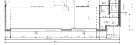

Hey all,
Ordering garage doors from a guy, and today he messaged me and said 10' doors are 121.5" wide, and 8' doors are 97.5" wide. Now that's 1.5" wider than the true measurements for each.
From my understanding and what I've read here/elsewhere, rough openings should EXACTLY match the door width. I'll fill the inside of the door with 1" trim, making it slightly smaller, then weatherstripping to that to seal the gaps.
Now since the door sits behind the opening, does it really matter? If i stick to 10' and 8' exactly, and install the door normally, nothing should really change as if the door was the same size, correct? I'm pouring a 8" stem wall, so once it's all said and done I can't go back and fix things, and down the road I don't want to be stuck with rough openings that are 1.5" wider than any 10' or 8' door.
Second to that, my garage will slope from back to front, but the 8' door is on the side. That means depending on grade, the floor on one side of the 8' door could sit 1-2" lower than the other. How do you combat that to get a proper seal?

The slight overlap should not be a problem as long as you have enough wood around the inside of the door to secure the tracks to.
You'd need a custom cut bottom panel to do this. I would pour a transition in the floor and a flat threshold for the door. Life will be much easier this way. You will still have gas and fluid flow to your main doors down hill.

I just had a "garage" door replaced on the shop. Part of what they did before ordering the door was come out and measure the opening.
Here are my house plans as they relate to garage doors, these are normal "residential" doors. "Trimmers" may bring this in a bit.

At the day job, we frame + 1” width on rough opening.
So for example a 10’ door (120”), we would net 121” between framing with at least (2) full 2x’s at each jamb.
The 2x’s are each 1.5” so 6”121+6=127”. So your stem walls should net 127” concrete to concrete. This is needed so the trim can be fastened but also to allow the garage door track to be anchored and extend to the concrete. I’ve done it with only a single stud each side, but not recommended.
Vertically we are typically +1/2”. So an 8’ door (96”) would get roughed at 96.5”.
When the door is closed and viewed from the exterior, encroaching too much on the rough will be visible as the reveals to the door panels will not be similar. For example, a raised panel door. Center reveals will be much larger than the perimeters due to the rough being choked.
The door rough opening shrinks via the trim and again by the weatherstrip for the door.
Your side door that is cross slope to the slab will be challenging. We don’t do that (only for small 2/6-3/0 man doors). If you do a dropped pan weatherlip detail you might be able to “warp the pan” to not need the tapered bottom pieces someone else mentioned.
What are you planning for a slab weatherlip detail? A depressed pan or a slope?
Below is a pic of a typical 16x8 garage door framing.
Here you can see a typical weatherlip pan. It’s dropped ~1”. The door closes and seals on the pan, not the garage sloped floor. Helps with driving rain. Pain in the *** with rolling floor jacks.
When we do man doors at a slab cross slope, we ensure the door bottom sill is level in the weatherlip detail.
Hope this helps.

You don't seal against the stem wall. The stem wall opening should be about 4" bigger than the nominal size of the door. Framing goes to the floor. If you think there's going to be interference with tracks, then you might need to adjust a little bit of the geometry.

I cant see in the photos but you run double 2x along the INTERIOR of the jamb? Then with your 1" jam board you'd come out to 120 exactly? Is this to just give wiggle room for doors? I assumed mine would still fit in this spec? Just unsure if the tracks would clear the concrete.
Are those boards PT since they're in contact with the floor?
We target 2 studs at the jamb butted tight to the stem wall down to the slab. Some times we only get one each side. In rare cases, we have had to rip the single stud to make it work. I prefer the ripped stud vs saw cutting of the stem wall. The stem wall is supposed to be a minimum of 8" above finished grade for the sill plate to be 8" min above finished grade.
If the stem walls are poured properly based on door width +1" and the double jambs are taken into account each side, and 1/2" trim is used at the jambs, then you should net the door size.
No - its a proper installation method. If the net opening is smaller than the door, it looks like **** when viewed from the outside as the margins/reveals are all cropped.
Your stem wall is likely thicker than your framing. The door is interior to the framing. Study the prior pictures and observe the flat 2x6's each side, above the door, and the middle blocking. This is to allow the door to clear the stem wall and provide secure mounting for the track, the torsion spring, and the assumed centered garage door motor track.
The boards adjacent the concrete are either pressure treated or membrane wrapped. Hard to see, but they stop short of the concrete by about 1/4" so they can't wick moisture. For trim, we use Boral or Hardy cementatious products.
I was planning on doing a slope
I like sloped door openings vs the weather lip.
For your side garage door that is cross slope to the slab, I think you will be stuck with a bottom garage door panel that has a taper piece at the bottom to seal. I have no experience with this. Talk with your concrete guy, he might be able to warp the slab opening to accommodate the door but I am not optimistic with this approach.
I don't know the slope of your slab, so the amount of cross slope drop at your door is not known. At the day job, for a 20' deep garage, we have a total slope of 3" (1.25%). Assuming your slab slope is the same, and a 10' garage door were positioned cross slope, then you will have 1.5" drop across the width of your door which I believe is too much for a standard bottom weatherstrip to accommodate; thus tapered bottom panel/piece others have mentioned.

Ok I think I understand now. Thanks for the clarity. You just install blocking behind the flat 2x6's to get them flush with the stem wall right behind down to the slab?
My stem wall would be 8"x8", so I would been 2.5" of clearance before I can run those inside vertical 2x6.

Yes pad as need be for the flat 2x6's to clear the stem wall on the inside. This will make your jamb trim deeper. What are your walls (2x4 or 2x6)?
If your concrete guy is agreeable, have him insert styrofoam in the wall forms to locally reduce the stem wall thickness on the interior side adjacent the garage door openings. This will aid your door installation. Our plans have a matching stem wall to the framing size so we don't have to pad the wall.
How are your trimming the garage doors on the exterior? Thin brick mold or 5/4x4 trim? If the thin brick mold, then you might be better off with just a single 2x at the jamb.

What is the reasoning behind the double 2x at the jam, over a single?
Not sure I know the reasoning why they target (2) 2x's at each jamb honestly. Perhaps its to give the framer some margin to ensure the garage door is properly centered to stack with features above (2nd floor windows, etc).
We have made it work with just singles each side, and sometimes ripped at that as the concrete was off.
And if I have enough clearance width could I not run the flat 2x6 from ceiling to the top of the stem wall and mount to that? Instead of padding it
Something like this?
If your concrete guy reduces the stem wall locally at the your garage door jambs to match your wall framing (2x6), then there is no padding needed. The flat 2x6 nails tight to the framing and flushes against the stem wall.
Your garage door track runs all the way to the concrete slab. You need clearance for the track to pass to the concrete slab and something for it to mount to. I zoomed in on your picture and the track is not installed and to my eye, it doesn't look like there is room for the track to pass the stem wall.
If the track were able to pass the stem wall as shown in your picture, the lowest most track bolt would likely be at the sill plate elevation and not the bottom of the track. That would be a question for your garage door guy if that was ok to not have the bottom 8" or so not fastened. I just looked at the Amarr garage door at my house and its track rests on the garage floor, yet the lowest bolt is about 12" up from the slab so conceivably it would work.

If your concrete guy reduces the stem wall locally at the your garage door jambs to match your wall framing (2x6), then the is no padding needed. The flat 2x6 nails tight to the framing and flushes against the stem wall.
Thanks again. I edited my post because I kind of answered my question but you beat me to it. I assume all he'd only need to reduce the stem wall the width of a 2x6 and space wouldn't be an issue like in the photo?
The video I saw that from the track seemed to BARELY fit there, and he did mount it like you said. I saw another higher quality video from a company that did (2) 2x like you said, and they only had to notch much less, but it was only a 4" stem.
I'll talk to my contractor, reducing the wall for 5.5" on either side seems to be the best option for sure. I'll just need to check with him to make sure it doesn't violate the stamped plans. I highly doubt it.
I appreciate the detail.

Doors are on gabled end. I think I can get away with 2x12 header but I'm just going to spend the few hundred extra and do 9.5 LVL over the doors.Garage(1).png
Add some dimensions to your sketch please.
If your wing walls are less than 4', I think you are into portal framing territory with continuous headers. Or Simpson Strong Walls ($$$$).
Here is a plan excerpt from one of our houses that has a garage that is 20' wide with (2) 8080 garage doors in the end wall. Note the continuous headers and the Simpson Strong wall in the middle. The Simpson Strong Wall was a PIA attaching to the center raised stem wall on that house type.
V
VietGnome
Feb 12, 2026
244
Atlantic Canada
My bad, I changed the door rough ins etc and hadn't redone dimension yet.
I gotta tweak a few things for the rough ins and get things symmetrical, but this is like the 99% solution. Do you think the end walls are too short? They were 4' exact until I had to redo the ROs. Gabled end, non truss bearing wall.
EDIT: Just confirmed, side walls to doors are 3'7" each side. I think something clipped weird and gave me the extra 3/16"
larry4406
Jan 27, 2006
20,124
Northern Virginia
My gut feel is you are well into portal framing. I think anything less than 48" wing walls is suspect. I am not a Code Expert.
Perhaps this linked thread can point you in the right direction on where to look in the Code.
Here is the Simpson Braced Wall Calculator. Hopefully its honest and not a product pusher....
Some good background reading on why and how.

Any reason to not push the header to the top and fir down the opening?
Being a gable end it may not matter unless there is a floor being supported.
V
VietGnome
Feb 12, 2026
244
Atlantic Canada
That calculator is way beyond me. The braced wall length and direction make zero sense to me.
I'm also not in the US so it doesn't apply super well, and our national building code is different. My understanding is it's not as prescriptive in our code. I'll send the measurements/dimensions to my framer and see what he says.
larry4406
Jan 27, 2006
20,124
Northern Virginia
That will not fly for portal framing.
Portal framing?
Braced wall framing.
As the header moves upward, the resistance to racking of the wall goes down.
Punch large holes in the wall for things such as garage doors, and the wing walls get slender and thin. This too greatly reduces the wall's resistance to racking.
When a wall racks from say wind loads, the building falls down. Not good.
Portal framing is one such method to build in racking resistance while accommodating large openings and slender wing walls.

I don't remember the measurements but my SIL had to do his like the pic in post #22. Not enough wing wall to prevent racking so code called it. I really like the double 2X, first because the header rests on 3" of stud vs 1.5" which to me seems a lot stronger. Especially if the header is supporting trusses vs a gable wall. Second because the inner 2X basically covers the concrete or block so you have one smooth surface floor to header. Sometimes that inner 2X just gets painted and other times it gets a piece of 3/8 to 1/2" trim covering it.

Thanks. I talked to my framer and he said the way I have planned is more than enough.
I'm doing double jack and double kings. I wasn't sure if I should add ANOTHER 2 as a jamb ontop of the 2 jack studs. However I think I might as it'll give me more standoff from the concrete and everything should fit?
But I've seen with a single jamb, double, and just sealed on the concrete.
As of now im planning to cap the entire inside with a 3/4" x 7-1/4" PVC trim

I agree portal framing is necessary. Framer is wrong in my opinion. If it goes for permits, it will get flagged.

I'm pulling permits, so I guess we'll see? In the interim I'll look into portal framing and do some more research. The NBC seems to leave things a lot less perscriptive, but I'll dig into the code again.
I'll see what is required when I submit for a permit in the future, and if it doesn't ask for enough detail then I'll probably reach out to a local inspector and see.
