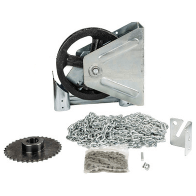

This is what I used on my pole shed door, it looks like you have enough room to mount the sprocket and chain assembly and it works great. Sprocket mounts on the door shaft and the chain wheel is below that with a bicycle chain connecting the two. About $130 on amazon or elsewhere. There are several different versions, with gear reduction and without, the sprocket uses setscrews and a key if there is a keyway in the shaft. I don't think you want to weld a sprocket on, that might make replacing a spring difficult.

When I built my Garage, I used LiftMaster LGO commercial openers which are designed to mount on the wall and connect the opener to door jackshaft via sprockets and #40 roller chain between the opener and jackshaft, which was all included in the purchase. The sprocket on the jackshaft has 2 setscrews that are drilled into the shaft. The system also comes with a clutch which easily disconnects the drive at the opener to allow opening the door in case of power failure or unit failure.
LM does not make the LGO any longer but I think have other similar commercial openers. You can see the black LGO openers on the wall next to each door and the chain drive up to the jackshaft.
BYW, as others have said, you either have a mis-sized, mis-adjusted or broken spring as the door should be neutral weight without the opener connected.

Wow you could eat off that floor!! I see what you mean those look like they would work well for my situation. And yes I supposed I’ll have to figure out what’s up with the springs maybe they weren’t turned enough.
This unit looks like it might be similar that I’d would chain up to the shaft w a sprocket

That unit looks like it would work. Make sure whatever you select, has an easy way to disconnect the unit from the jackshaft for manual operation (mine has a pull chain which operates a dog clutch on the operator output shaft) Most of all search for reviews online, Some of the newer LM medium and lighter duty jackshaft products, like the LM8500 have horrible reviews.
If you can try and get a unit that is WiFi and MyQ compatible, these are the features that allow you to operate the door through the LM MyQ app and get notifications when someone else does, or you forget and leave the door open. The LGOs are not compatible because they were bought before all those features were available and I really miss these features as all my other garage doors have it.
