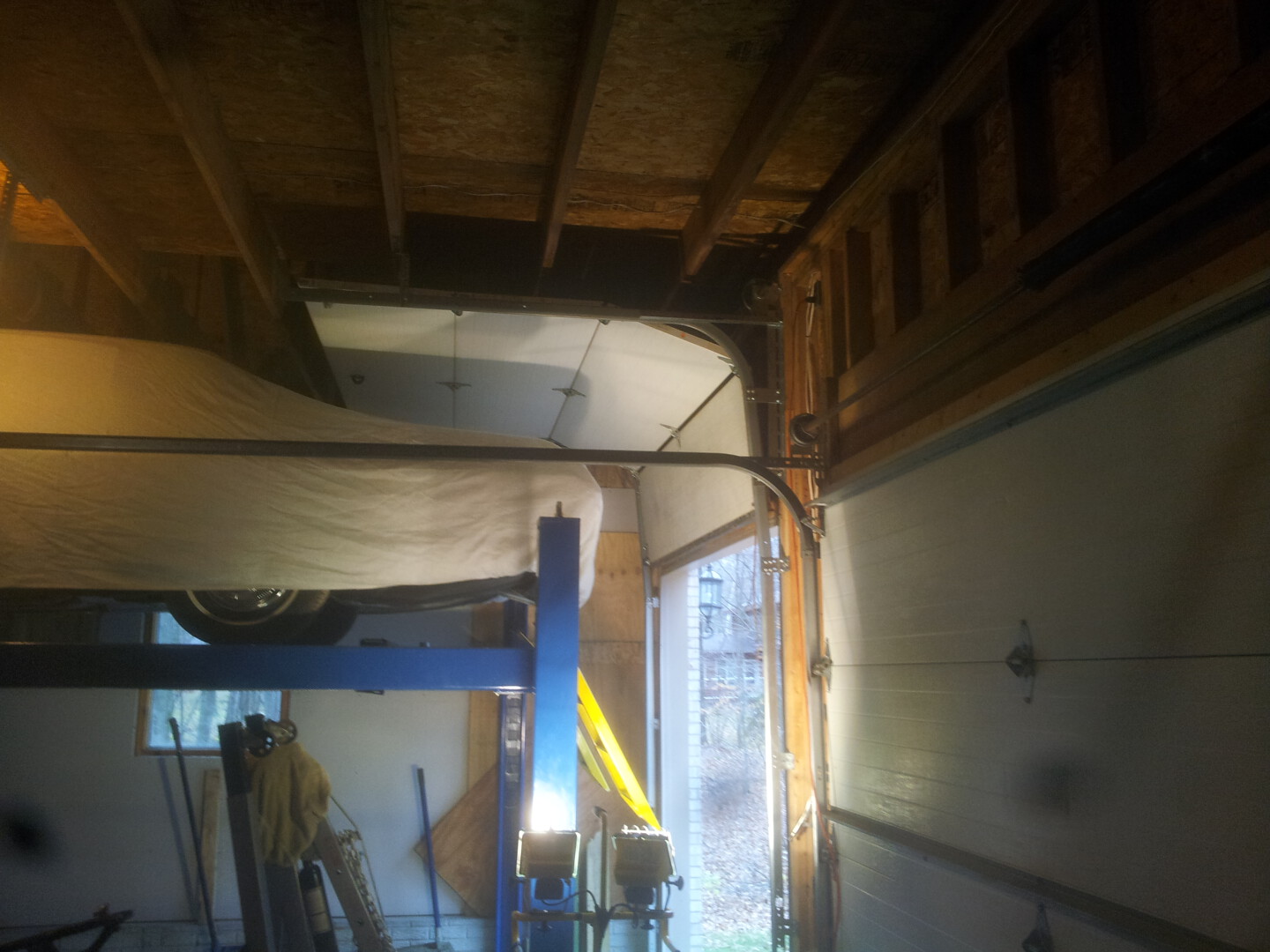

I recently bought a 14k bendpak auto lift, I have 12' ceilings with 8' doors, but with a car on the lift, the garage door was not usable. So I needed to convert it to high lift!
Requires new springs, drums, cables and an angled vertical track extension. I just wanted to pay someone to do it since I've never messed with a garage door before, I know what I'm like, I'll spend hours researching and looking up stuff, what's needed, reading tutorials...I just wanted to pay someone for once...

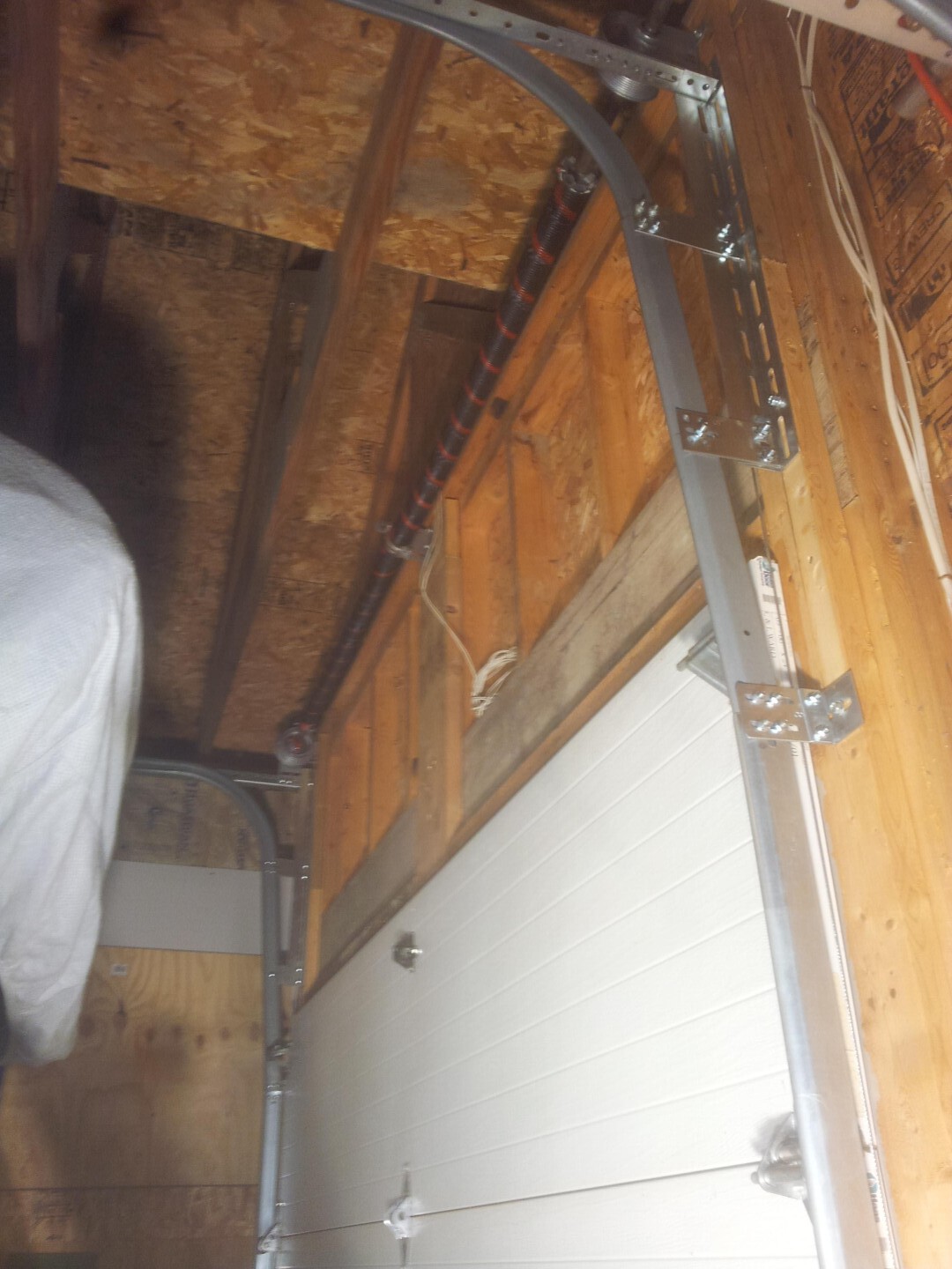

Installed it yesterday with the aide of his super detailed tutorials from assembling the vertial extensions, to how to wind springs to general door adjustment tips... and didn't have so much as any little hitch.

On a normal door, it goes horizontal as soon as it's go up, so that reduces alot of the weight the spring has to carry. On a high lift door, it has to carry the full weight of the door a few feet (27.75" in my case) vertical, before it goes horizontal. So the springs have to be heavier to carry that weight, you need different drums because the outside of a high lift drum is much bigger diameter giving the drum a bit more leverage to lift vertical, and you need longer cables because the lift hardware is up against the ceiling and not just above the door header.
Kit was just over $200 and included 2 new springs (they converted me from 1 spring to 2 for alot of reasons), new cable drums, new cables, and high lift bracketry. I also bought a jackshaft opener from them (Liftmaster 8500) (another $335).. but not installed that yet, I want to find an older version of that same opener (the 3800) which doesn't have the new Security 2.0 **** that isn't compatible with anything existing, like homelink'd cars or older openers.
