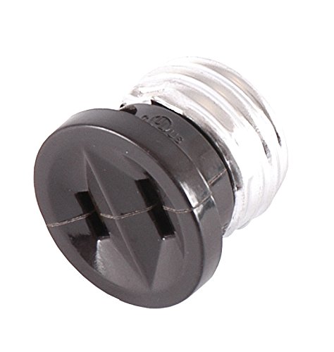

https://www.amazon.com/dp/B002DN6QX2/?tag=atomicindus08-20
