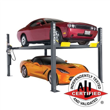

I just received a garage slab quote that read the following:
720 sq. ft. of 6" thick reinforced concrete slab placed and finished
17 cu.yd of 4000# 3/4 PSI concrete ready mix included
#4 rebar supplied and installed @ 1ft on center each way
6 mil vapor barrier supplied and installed
expansion material supplied and installed
They said mesh would be cheaper, but in my request to them I asked for rebar, not even thinking.
I will be putting one of these type of lifts in on one side of the garage to store vehicles
do you think I need rebar or could I get away with mesh?

Woof. This one is hard. Slabs seem to be highly regional in terms of design, likely due to difference in local soil conditions.
I'd be after the requirements set by BendPak in terms of mounting that lift.
Here, we use rebar, but also do 24" around all the sides and may include 24" beams of concrete - and that works for a shop where I've parked 22,000 lbs of vehicle and trailer with 4" of concrete.. But I've seen slabs built up north with no steel at all (fiber reinforced).

If you're concerned about cracking around the posts, locate the posts & thicken the slab there and possibly a small rebar box at the bottom of the thickened area, suspend from the top rebar layer with verticals. Added rebar might be overkill.
No cracks inside my workshop, 2 years old, ~5" thick, 4000psi, 3" slump before plasticizer (100+ foot pump job). #4 rebar 16" oc ew, in chairs & very tightly tied.
