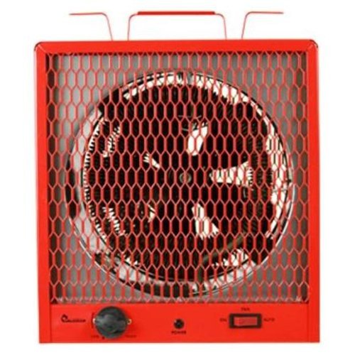

I bought a 220 volt electric portable heater from Northern that works well if you have a 30A plug out there. Mine heats a 12X24 section of my shop no problem on it's low setting for about ten bucks per month. We just had some freezing weather with lows around minus thirty degrees and it still kept things at fifty to sixty easily.

5000w electric as a minimum would be my thinking. Search for the G73 Dayton type posts.
This, But the Fahrenheat is the same thing for less money.
EDIT
The Dayton G73 is the exact same unit at the Fahrenheat FUH54. The company Marley makes them both but just slaps a Dayton sticker on it for Grainger. I just installed one in my shop 2 weeks ago and it works just fine. I paid $229 for it at Farm and Fleet. I wired it with 10 gauge wire on a 30A 240 breaker.

I really like electric heat, given the requirements meet your needs. It is clean, quiet, easy to install (assuming you have the necessary service), and total cost of ownership (unit price, install price, operation, etc.) is not too bad. Of course, if you spend lots of time in your garage, electric might not make as much sense from an operational expense standpoint.
My old garage, 18x24, R13 in walls and just OSB in rafters I had an electric heater with built in thermostat. Just sat on the floor next to the 220 plug. When I needed to use the 220 welder, would just unplug. I only had 30 amp service out there, so I could not run both at once. Two settings, I think 3200 watts and 5600 if I remember correctly. Worked great! Have any temp I wanted out there any time of the year. When not in the garage I would dial it back to 40 or so to keep it above freezing.
